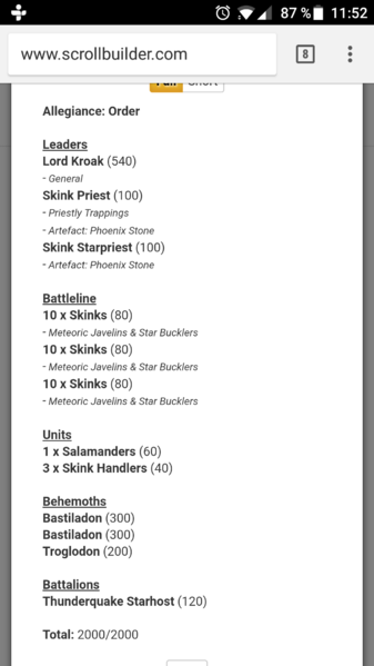

  12. Workschmock
    Workschmock New Member
    14
    16
    Hi there,
    My ideas (though i've never been to a tournament)
    List 1: Everything hiding behind two bastiladons advances towards the enemy (starseer and kroak buff their saves, priest gives rerolls) Kroaks snipes Characters and mortal wound dealers with comet and deliverance when closer. Troglodon threatens incoming CC Units. The three behemoths heal D3 Wounds each turn but it's vital to kill Everything with mortal Wounds, since rend and normal wounds will do nothing against your bastiladons. Either you go close and f*** up your enemy with dual Sotek Bastis and celestial deliverance or you keep your distance with comet and dual Laser.

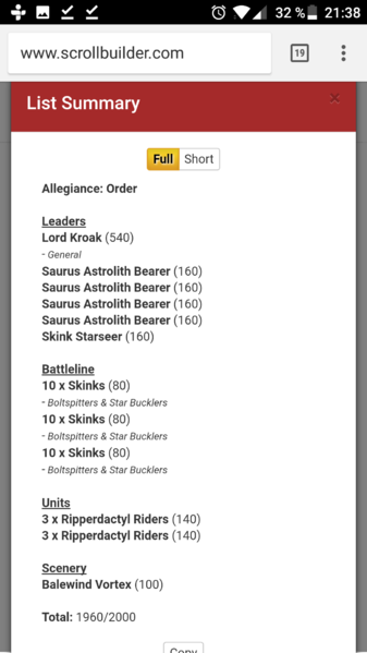

    2nd List: passive aggressive Kroak dwells behind scenery with his 4 bearers guard, sitting on his balewind vortex and making your enemy cry through his celestial deliverance with a range of (3xD6 + 32)x2 inches... Starseer pushes Kroaks damage output to the limits. What do you think?
    In both cases skinks take objectives.
  13. Seraphage
    Seraphage Well-Known Member
    867
    1,148
    The 2nd one might work if you protect the skinks. The first one could but only in a couple of scenarios. There are 2 that the objectives are 4, 1 that are 3 but you need hero within 3" to take that you 'd have some serious trouble as a blob moving around I'm afraid. It would be fine *although not sure if enough to win - definitely enough for a tie and then countdown to points* for Gift from the Heavens where each player controls 1 objective that randomely drops down at 2nd round and the the 1st mission where each 1 controls one from the start !
