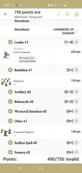

    Update on the list. So I went with @Schwaaah 's suggestion. I was up against my friend the took this SCE list.
    Arcane Bolt was the only spell used (general buffs it to d3/d6)
    Mount Trait Wind Runner.
    I definitely felt the devastating effects of mortal wounds, the lord-arcanum's Spirit flask of once per battle doing 3 MW to all units within 3" wrecked my guard units the two games we played. They felt very lackluster with 1" range, however, I did forget to use their bite attacks several times. When they were regularly attacked though they had great survivability thanks to a hero nearby... Still, though I was thinking of making them one large unit of 10, I fear they're lake luster range will bite me in the rear.
