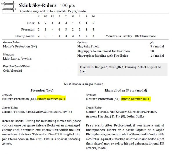

    One thing I'm unsure of is the AS on the Pteradon Riders, every other Skink has Innate Protection, but I can't find it in their wording. I assume 6+ with no Shields?

    These are my ideas for unit configurations and my understanding of how the Caimans and the Cuatl are allowed to be positioned. Please correct me if anything is off.
    77,525
    248,338
    They do have innate protection (6+). I've highlighted the entry below ...

    I believe that both Caimans in Skink Braves unit and a Cuatl in a Temple Guard unit may be placed anywhere within their respective units. The reference for the Caimans can be found under the "Combined Strength" rule on page 9 which it states that "they do not have to be placed as far forwards as possible, but can be placed anywhere in the unit". The Cuatl has the "Palanquin" special rule (page 2) which states that they lose the Front Rank rule (and therefore can be placed anywhere in the unit).

    Cool thanks, the construction of the Sky-Rider entry seems a bit confusing though. I assumed the Innate Defence reffered to the mount itself.
