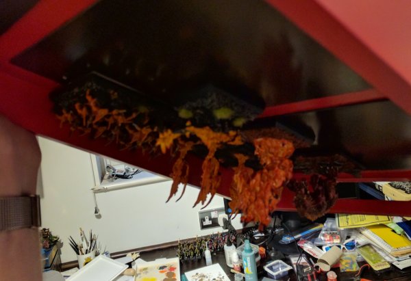

    I solved the problem! Each unit model is glued to a sheet of plastic cut to the size of troops, with magnetic rubber on the underside of each troop. I then had steel sheet cut to the size of hordes / regiments etc. which either 2 or 4 troops then stick to. Each monster / hero has rubber steel sheet stuck to the underside. I then lined a tray I can carry the army around in with super strong rubber magnet sheet. The metal trays on the underside of units now have a brutally vice-like grip on the carrying tray (I need a tool to lever them off, so it may be a tad strong), but the steel rubber sheet attached to the underside of heros / monsters sticks to it just perfectly. It all worked rather better than I had expected!
    p.s. the Fire Drake (old Carnosaur) on there is entirely metal
    pendrake, n810, NIGHTBRINGER and 2 others like this.
