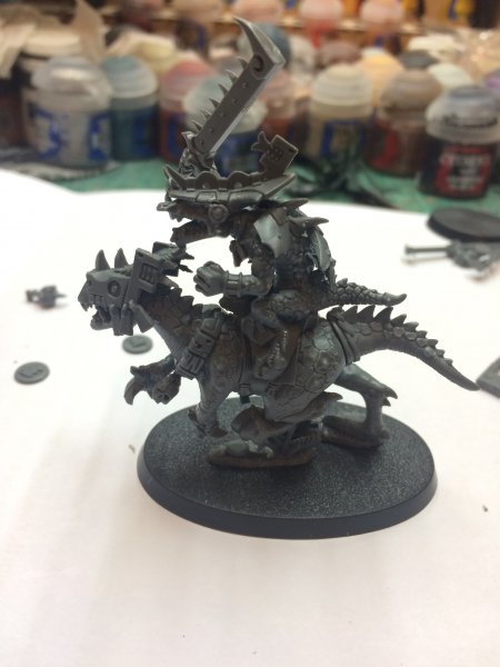

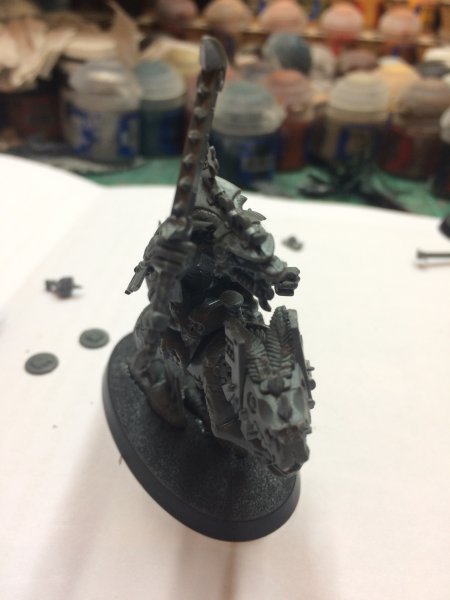

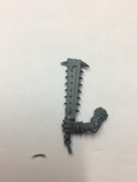

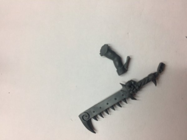

    Scarvet on cold one
    Simple this one, Coldone built with the champions head, rider has champions head, shield on his back and both arms are from the warrior set, cut the hand off the right arm and attach the blade for the oldblood from the Carny sprue.

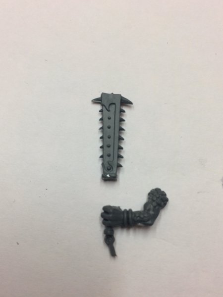

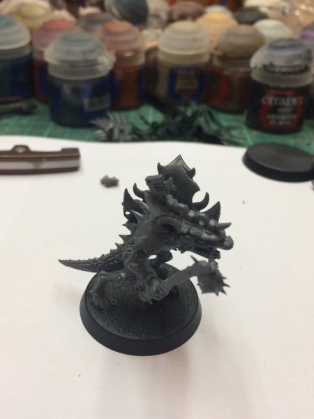

    Sunblood or Oldblood on foot
    Again very simple this one, standard warrior with Saurus Knight champions head, Mace weapon in right hand and use the spare Carny top head piece as his shield, shoulder armour from the warriors sprue.

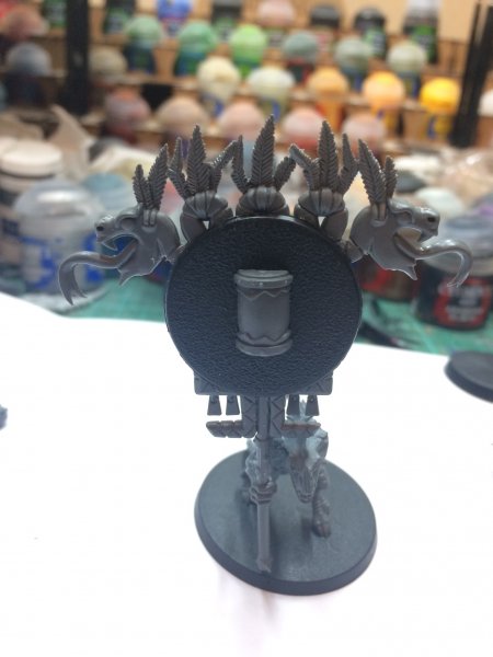

    Astrolith Bearer Part 1
    This one is a bit more in depth but still simple if you take your time parts you will need,
    1 warrior and warrior head
    2 star icons, warrior kit

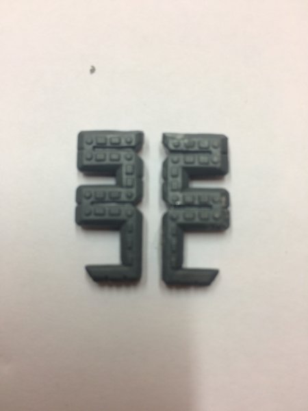

    1 banner arm, warrior kit

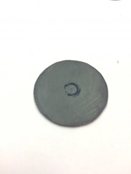

    1 32mm base remove the lip
    1/2 drum from the warrior kit, file it flat on the back
    2 snake banner tops, Knight kit
    1 extended arm, warrior kit, remove the weapon above the hand
    1 suitable weapon for you bearer
    Any bits you want to adorn on the bearer.
    Glue the warrior to the 40mm base, use a suitable head.
    Cut the Star icons just below the head and trim neat
    Trim the rivets and any out sticking parts from the banner pole top
    Place the banner arm between the icons and glue in place, the arm wants to be at 90 degrees to the icons.
    Attach the arm to the warrior body, it should look something like this.
    Trim the base flat
    Trim the drum flat
    Attach the base to the icons and then the drum to the base like this.
    More in part 2
  6. Crowsfoot
    14,490
    Astrolith Bearer Part 2

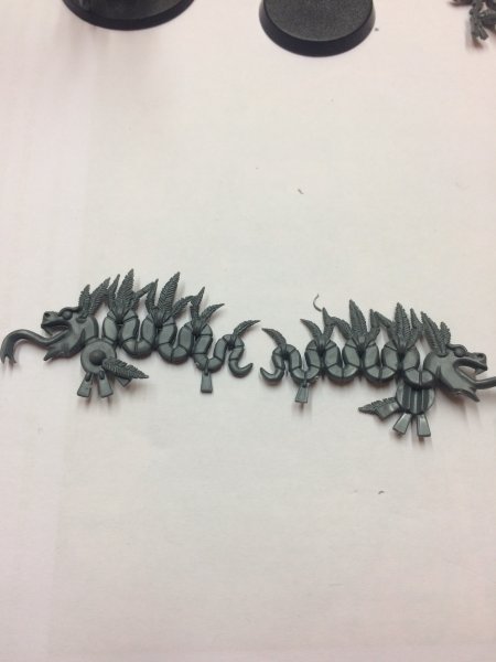

    Now take the two snake banner tops
    Trim flat where it would attach to the banner pole, cut them carefully on a joint as below and glue together
    Attach to the back of the base as below
    Attach any extra bits to the base front as below.
    Take the out stretched arm and chosen weapon
    Glue together
    Attach the arm to the model
    You can add shoulder pads, extra weapons etc if you wish.

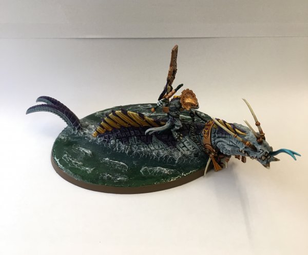

  7. Crowsfoot
    14,490

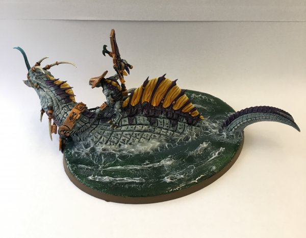

    Troglodon part 1
    Take the head and tail and assemble together, when dry take the head and cut it square at the bottom.

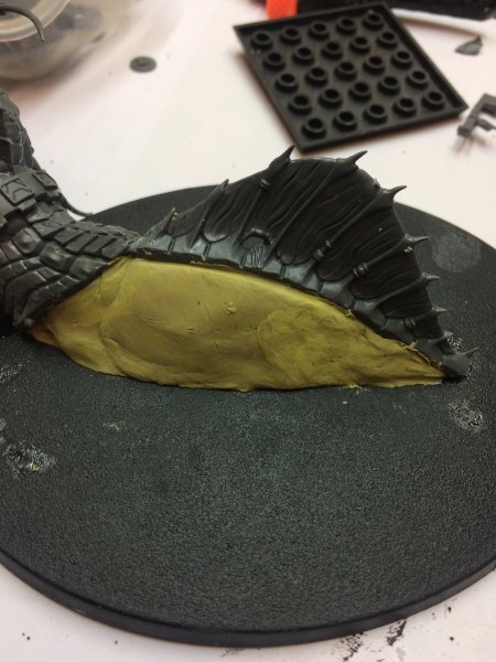

    Now stick this to the 120 oval base, take the large fin section and use it to place where the tail would go, leave a small gap and glue the tail to the base, now glue the fin in place, you may need to trim it to sit flat and you can cut a bit of sprue to support the head and fin, like below.
    Leave it to dry over night before starting to sculpt the body.
    Once dry take some modelling putty/clay and fill under the fin to make a body shape, don’t go past the scales in thickness and it does not need to be precise, leave to fully dry,pic below.
    Part two to follow
    JTSleep, Noxolotl, GOSD774 and 14 others like this.
  8. Crowsfoot
    14,490
    Troglodon part 2
    Once fully dry take your finishing putty/clay (im using greenstuff) and apply enough to cover one side, apply to the thickness of the scales, pic below.
    Now smooth it a little with a wet shaper or your finger, don’t lick your finger dip it in a water pot.
    Now take a shaper or tool you can use to make lines, I looked at the carnosaur for reference and just make squares and rectangles then I used the rubber clay shaper to apply texture, just gentle stab the greenstuff,pic below.
    I put the skink oracle on his back as I have loads of priests but you can leave it off if you don’t have a priest model.
    And there you have it a relatively simple way of making the most of your Seraphon starter box.
    Couple of pics with the oracle attached.
    I hope you find this useful and keep an eye out for a follow up tutorial on painting your Starter set.
    And here he is finished,
