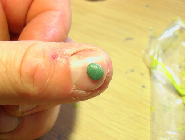

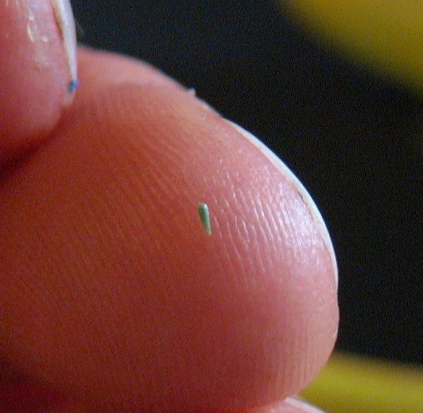

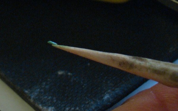

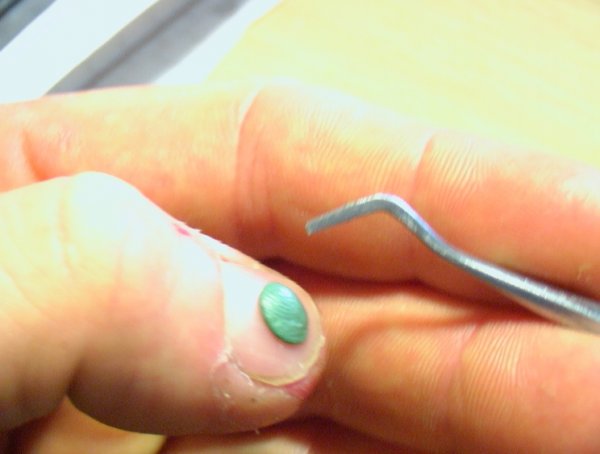

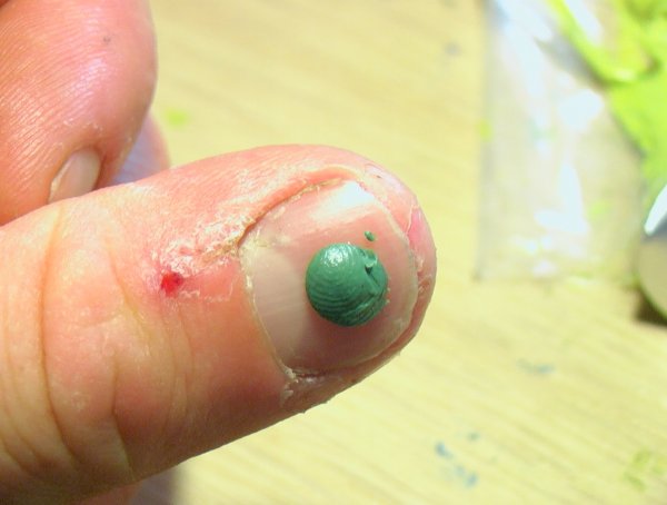

    Small tut on teeth:
    1. I mix up green stuff and place it on my thumbnail.
    2. I then use a metal tool to pull a small amount off the main blob.
    3. Photo of tooth pulled off from the main ball.
    4. Roll quickly between two fingers.
    5. Wooden tool (that I made), touch the tooth and it sticks on the end, then simply slide it into the mouth, quick, simple and easy.
