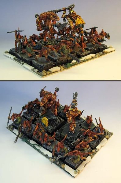

    Once I began to use my mass amounts of skink/kroxigor cohort units, I realized right away that I was going to have to solve some issues. o_O
    With 5 of these units alone, it was taking me forever to pack and unpack them! I was also getting frustrated with the "electric football" effect as I moved them across the table. Relearning the jigsaw puzzle of getting them to rank up over and over was also irksome. :oops:

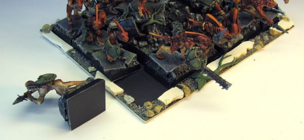

    Not wanting to rebase them or spend lots of $$$$ on GF magnetic bases, I did an experiment using refrigerator magnets. I had been given a bunch of them, so I had nothing to lose.
    A few of the sheets went onto a mattboard movement tray (slides very easy over any surface) with the magnet side up. I then cut out a piece of magnet to put on the bottom of every skink base (see pictures). I used RE magnets on the kroxigors, since they were too heavy. To make a nice decorative edge, and further secure the little guys in the tray, I put my usual baked sculpey material around the edge. I am in the process of painting that right now.
    I have been able to do this with the plastic COR, and even a temple guard unit with Babo. Now it takes about 5 minutes to pack and unpack everything.

    4,508
    73
    Simple fridge magnets were strong enough to hold them in place during transportation? Wow that is impressive. Do you just put a bit of padding around the unit so it doesn't slide around?

    201
    30
    For the moment I have been using blue-tac to hold them in place. I might try another way to hold the trays in place that does not risk pulling away some of the gravel, however. The blue-tac is very strong.

    186
    6
    Hey, very nice paint job here. I like the bases too. I have my entire army magnetized and I have found that wal-mart carries a pack of magnets for 77 cents that is enough to do about 25 models (25mm). I cut them to size and then glue these pieces to the bottoms of the model and then I went to Home Depot and got a sheet of steel (18" x 12") for $5 and then cut the steel to the size of the movement tray. It has a super strong bond and takes me about 5 minutes also to load and unload. Just my 2 cents. Again, very nice looking and cant wait to see it all done.

    SuperThunderLizard New Member
    6
    Your work is really amazing and very inspiring to a new Lizardmen/Fantasy player like myself. I was wondering, how wide are the scenic borders on your movement trays? It seems the border on the front is wider than the sides, which is a really a good idea since the front is what will be seen the most by the other player and it allows you to add more detail. Thanks for the help!
