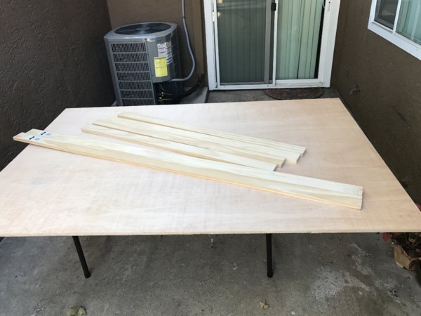

    Step one complete:
    Ended up spending less than $100 in materials. I got:
    (1) 1/2" thick
    4x6' Sheet Plywood
    (2) 3/4" thick
    72" x 3" Wood Slates
    (4) 3/4" thick
    46 1/2" x 3" Wood Slates
    and some 1 1/4" drywall screws
    It will be sitting on a fold out table I already own.
    Now let's start putting this together...

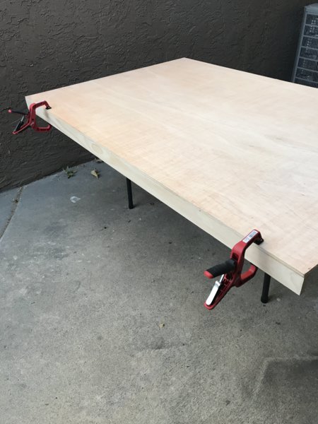

  5. That1Lizard
    That1Lizard Member
    16
    50

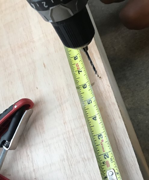

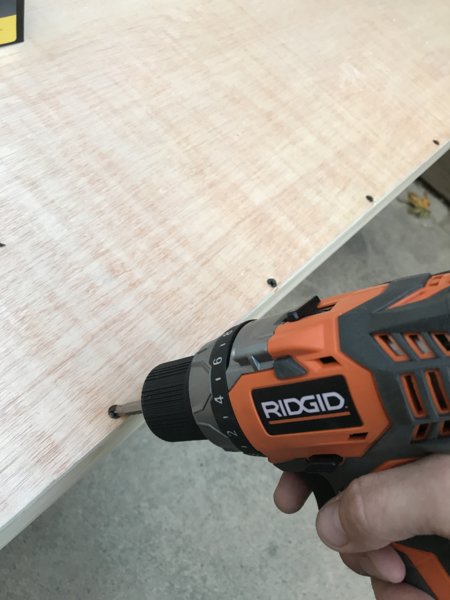

    So starting, I take the first 72" slate and clamp it down flush.
    Then I take my drill using a 1/8" drill bit and drill holes in it every 6".
    Then I take the drywall screws and drill them in, just a tad deeper than flush with the wood.
    I repeat these steps for the other 72" slate.
    Warden, Jorgik, Bowser and 1 other person like this.

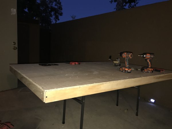

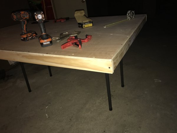

    Then I take two 46 1/2" slates and wedge them on the other two ends. I essently do the same thing with drilling and putting in screws except I set the screws from the outside going in rather than from one end to the other.
    And it starts to get dark, but I will not be stopped! So at this point we have this:
    Not perfect but it works. Almost there...

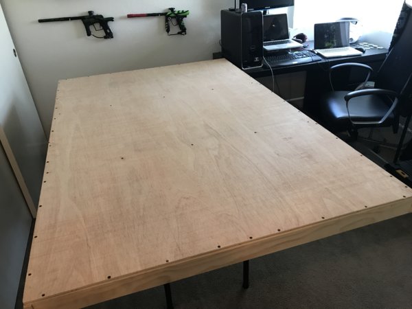

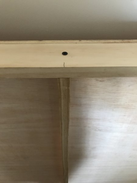

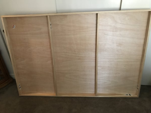

    Ok so to wrap this up! (Sorry work has been hectic this week).
    So I don't have pictures remaining of my working in progress, but I do have final pics.
    Basically, I marked with a pencil every two feet along the long edge of the table, that helped me place my two remaining 46 1/2" slates. I wedged them in making sure each end match straight with the pencil markings, then I drilled in the screws on either end as so:
    Then, I used the tape measurer to make straight line from one screw to the other and drilled in five screws along the straight line ensuring it went in the slates.
    And boom! It was done!
    And there you have it folks! In summary it actually only took me about two hours to do and it's pretty simple, not as hard as you would think!
    Not sure what is next on the agenda but stay tuned in the future! Thanks everyone for all the comments and enthusiasm! It really helped motivate me.
