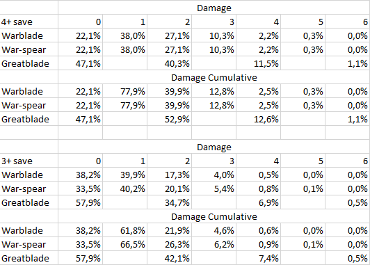

    This is what I meant by looking at probabilities instead of averages. Below you find two tables. One for a 4+ save and 1 for a 3+ save.
    This really helps me alot when looking at the damage output. It also helped me alot in my last tournament where I knew exactly the probabilities to take a hero out in 1 go (with the basti). While all weapons below have the same averages on damage output against a 4+ save, the probabilities do differ alot.
    For example with a 4+ save, the greatblade has a 47% chance to do no damage. 0% chance of doing 1 damage. But the highest chance of doing 2 damage. On this you could vary your tactics what you use it for.

  13. Koriialstraz
    Koriialstraz Well-Known Member
    206
    272
    Can you explain how you do your maths ?
    Like that I can use it too :D
  14. IggyStarhost
    IggyStarhost Well-Known Member
    493
    829
    Its a biniomial distribution. An attack either does a wound or it doesnt. Maybe when I have time I can make an sheet with all our troups. Which units would you like to see?

  16. IggyStarhost
    493
    829
    To add: cumulative you must read as atleast 2 damage / 2+ damage
  17. Canas
    Canas Ninth Spawning
    6,800
    10,461
    right.. now it makes sense, was reading it as "at most X damage" which didn't add up...
  18. Koriialstraz
    206
    272
    Ho, rights, I didn't think in that way.
    I think I will try it first (I like doing some maths time to time :) )
  19. IggyStarhost
    493
    829
    Nice! Excel has a nice builtin formula to maken it very easy! If you know your way about maths its very easy. Have fun!
