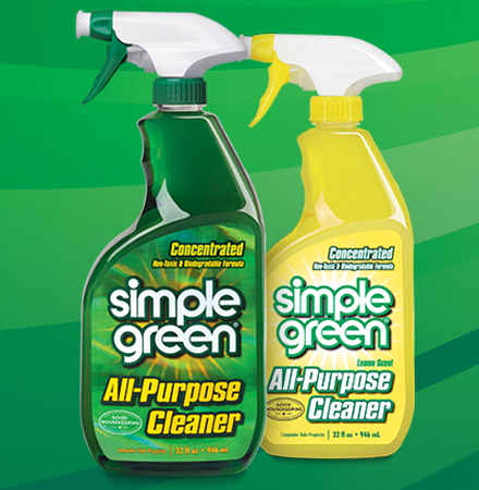

    I have never tried this stuff. But the better painters on the Reaper Forums recommend a soak in this stuff followed by a scrub with a soft tooth brush.
    Metal minis: can go days.
    Plastic minis: hours** but not a full day.
    Paint: is not supposed to survive more than about 4 hours.
    **They left one of their plastics for a couple of weeks (by chance, as is always the case with the best Mad Science) and it asploded, delaminated, and turned fluffy.

    I have also heard good things about simple green, you should be able to get it from walmart/local shopping store.
    Also this clip from youtube gave a good overview of the process, plus the video showing the old painted eldar model (of questionable painting quality) getting stripped and ready for a new paint job.
    Luetin09: How to Strip Paint from Miniatures
  9. pendrake
    5,022
    http://www.simplegreen.co.uk/
    @Phoedinn is in the UK; not sure Walmart is. But that link ought to identify places to find it. Wickes? maybe...

    We have Asda over here. It's owned by the same company but I'm unsure how similar they are.
    Annoyingly I had a look at my local shop but had no luck :( they seemingly only sell toilet bleach and own brand kitchen spray.
  11. pendrake
    5,022
    In the states SG is carried on the contractor cleanup/cleaning products aisle at all the big DIY stores. I thought Wickes was one of those places in the UK. And there is another that goes by initials... B&E, D&Y..? Looked it up once but not remembering. ~~~ goes and looks ~~~
    B&Q, that was it.
    I looked thoroughly at the UK website link and they don't list any retailers, so they may not be distributing it to retailers in the UK, opting to sell it direct over the internet instead.

    Sellers on ebay have it but it is cheaper direct from the supplier.

    Yeah, I think any degreaser would work. I've been using one called Citra-Solv. It wrecks plastic in minutes, but soaking metal in it for hours (or days) is no problem. Paint comes off with a toothbrush, though I'd recommend a stiff one rather than a soft one.
    I just picked up some Simple Green for the first time, and I've got both some plastic Skinks and a metal Slann to strip. I'll let you know how it goes!
