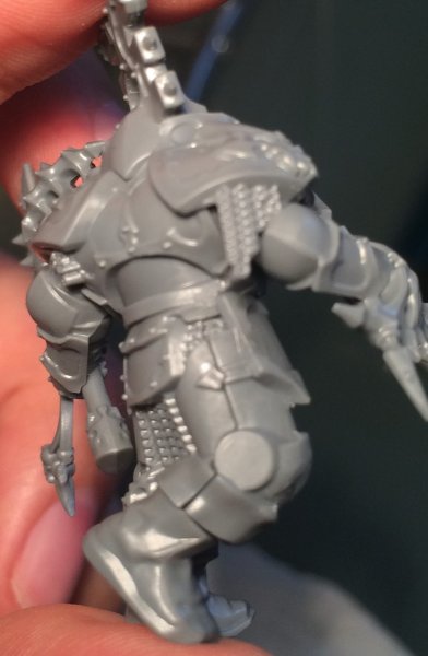

  4. Realjuan
    Realjuan Well-Known Member
    105
    311
    The model that I was working on is the bottom right model in this picture. In my opinion the right mini-shoulder makes it hard to reach the neck, and some underneath shoulder armor. Problem is that the miniature body is two-piece and around the same area you can see the line between the pieces. I do not think this model is a big deal or that I wont be able to paint it, but it did make me question the way I assemble and prime my miniatures.
    My first batch of miniatures were barely clean of imperfection, lines, or fixed with green stuff. I am trying to make my AoS miniatures better.

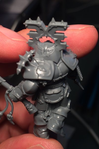

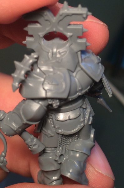

  6. Realjuan
    105
    311
    Sounds silly, but I never thought about scraping before gluing. You may have a better grip, angles, and view. Looking at the miniature closer, I wonder if my gluing is not as good as I thought. The gaps look to be too big. Do you have a recommendation or do you get the same results yourselves?
    Here are some of the locations that I think need to be fixing.
    1. My idea is to put a line of green stuff and then push it to make the area smooth. Else when I paint it, I think the gap will show up and shade may go in.
    2. I was a little disappointed in GW here, because if you see the other side of the armor the arrow and the indentation of the shoulders are more clear. I wonder if I should attempt to copy them with green stuff.
    3. There is a small gap on the skull, which probably going to be left like that since I do not think I can figure how to fix it.
    Apologies for the bad pictures, next time Ill try to zoom to the correct location.
