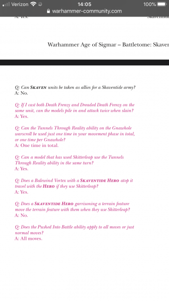

    I still haven't seen the FAQ/Errata that makes the Skitterleap rule universially applicable.
    Any news on that front?
  10. Nart
    Nart Well-Known Member
    1,394
    2,795
    No, but this is fair RAW. That's the point.

    I believe its in the designer commentary. I cant access Warhammer community (which includes the faq/errata/comments) while at work due to filters.

  13. ILKAIN
    ILKAIN Well-Known Member
    1,845
    3,388
    Per the rules, we can garrison with the BVW, but NOT in conjunction with a teleport ability. You can’t LOSAT into the garrison (wether on BVW or not)... but you CAN garrison while on the BVW.
