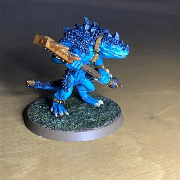

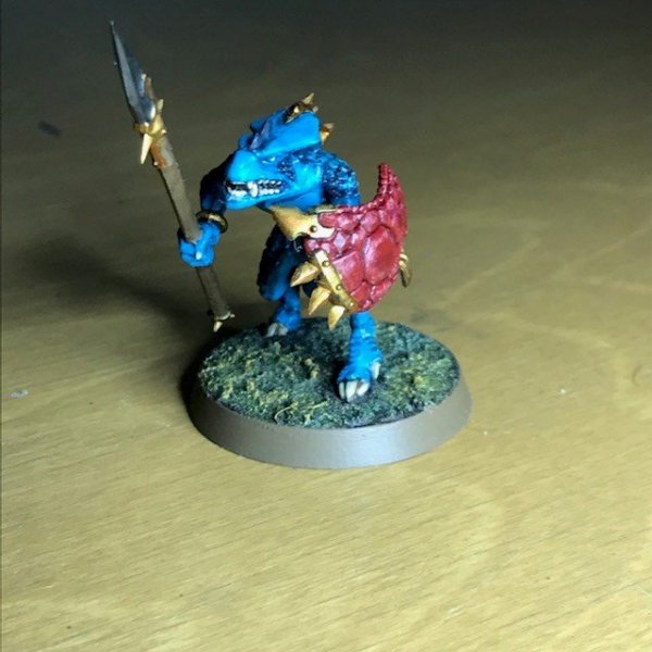

    Here are some examples from both paint jobs. Unfortunately I don't have the greatest lighting, since I haven't received my new lamp yet.

    Looks great!
    I love the Kroxigor.
    Keep it up

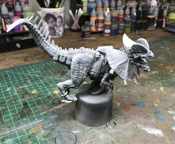

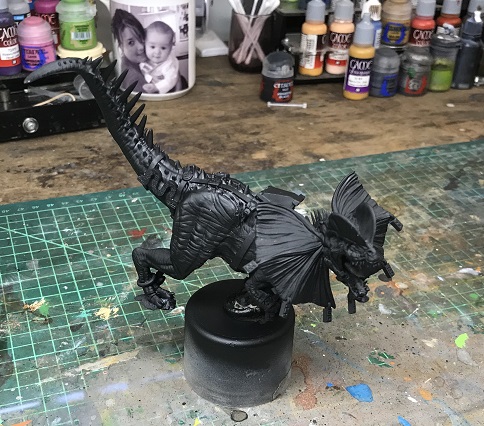

    Gentlemen,
    Underpainting. I just did the following without an airbrush to show:
    Step 1, hit it with a can of black primer spray, GW is good shit for this, its thin and drys fast.
    Step 2, with a can of white primer, lightly zenthial spray, leaving the underside of things considerably darker.

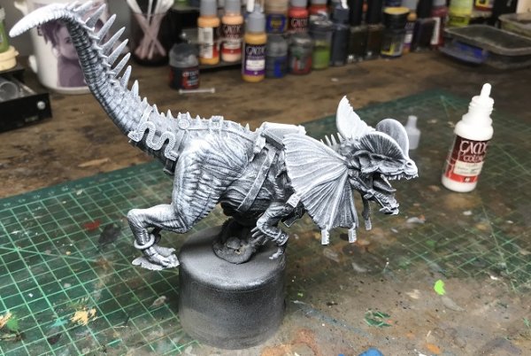

    Step 3 , Drybrush all of it white.
    I usually work with an airbrush when applying colour. But if I was to move forward without an airbrush I would either apply my colours using a little bit more thinner than usual so the high points pop and the low points stay dark or I would take the easy route and throw contrast paints over this.
    Contrast paints over underpainting is the easiest way for your mini to look good with very little effort.
