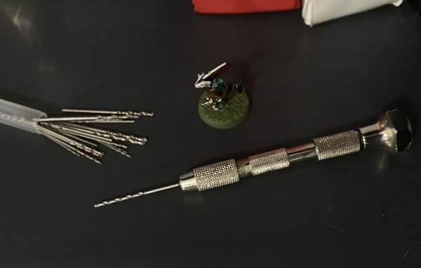

  6. Lizards of Renown
    26,482
    What drill did you use for that?
  7. Warden
    6,464
    18,256
    Standard hobby drill I bought at a craft store years ago (Hobby Lobby/Michaels/AC Moore):
    If it had a brand I can't find it on the drill itself.
    It came with a few dozen drill bits that cover everything from the standard Space Marine-sized boltgun to the tiniest gobbo-pistol.
  8. Lizards of Renown
    26,482
    @Warden how do you hold the model in place to be drilled? A vice seems like it would break the model...
  9. Warden
    6,464
    18,256
    I don't use a vice, just my hands (model in one hand, drill in the other).
    The it's a hand drill, so the drilling force is as strong or soft as the force you apply with your hand. It can be a bit tricky, but if you test on an extra piece of plastic first you can easily get the hang of it.
    If you need, I find it easier to conduct the drilling before you even assemble the model; and for larger holes make a smaller hole in the center first so you don't accidentally drill off center.
