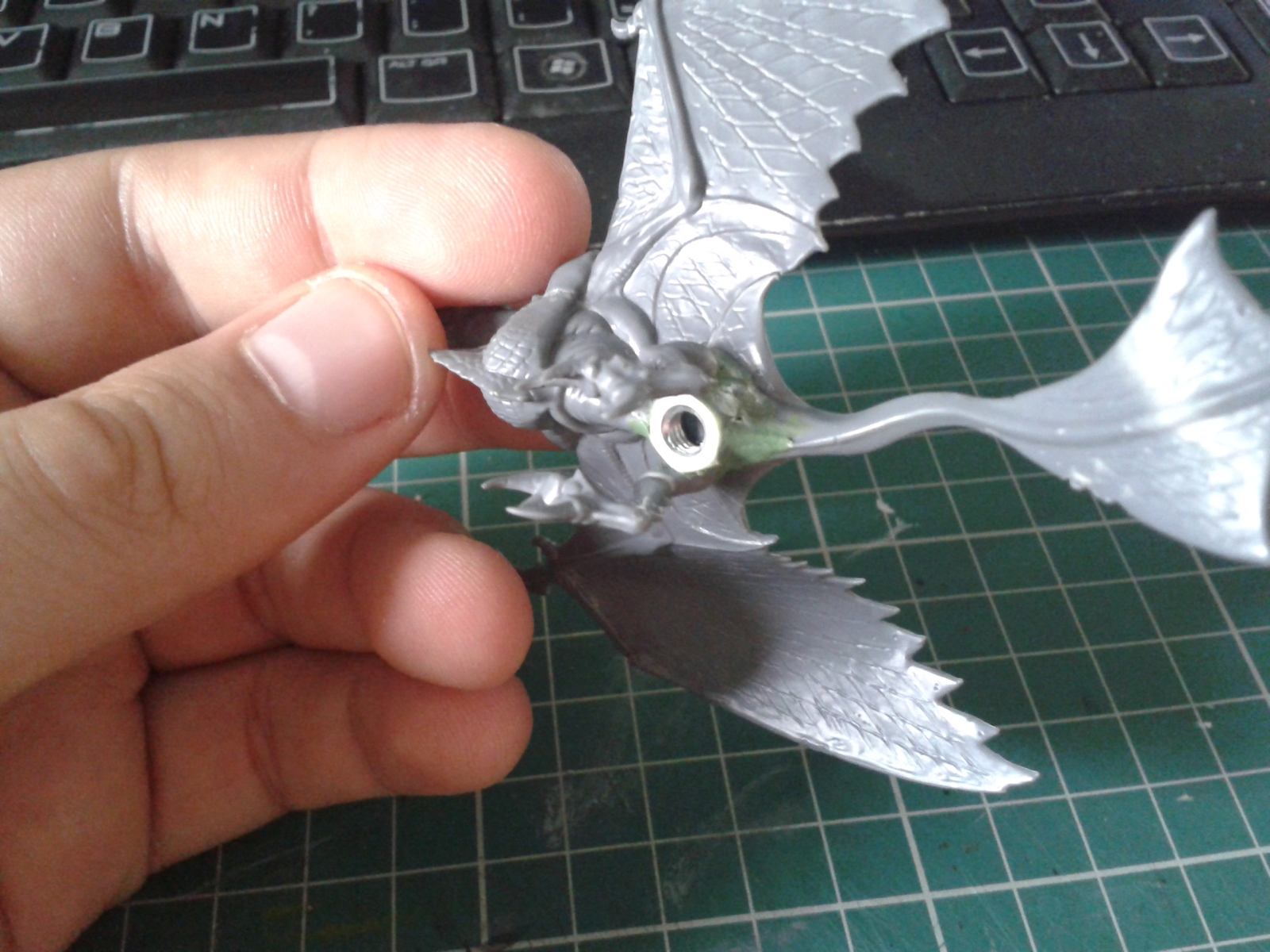

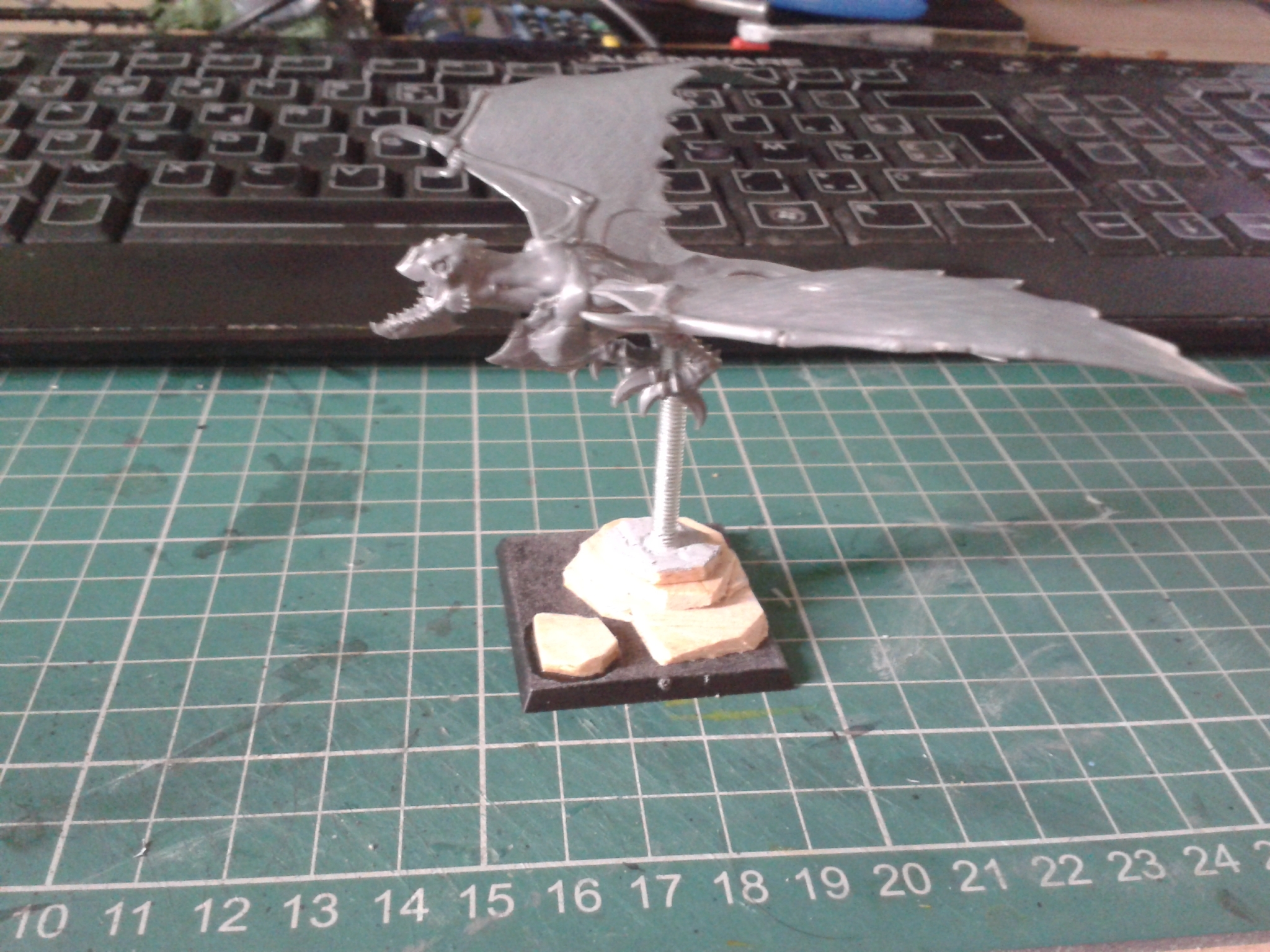

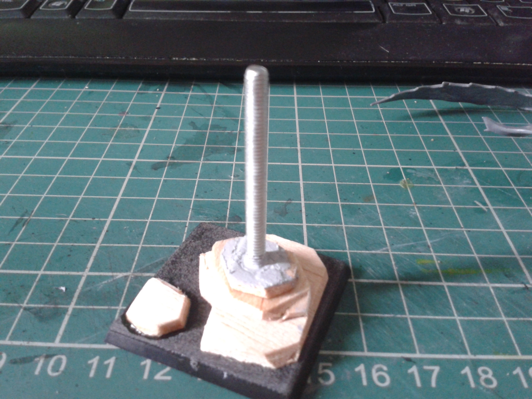

    I built a base which included the first part of the removable base:
    Then I started cutting into the Ripperdactyl model (only for people with a strong stomach :p) and glued/GSd the nut in place. I've still got some more GS work to do to make it look whole again when it is dry.
    Model on the base:

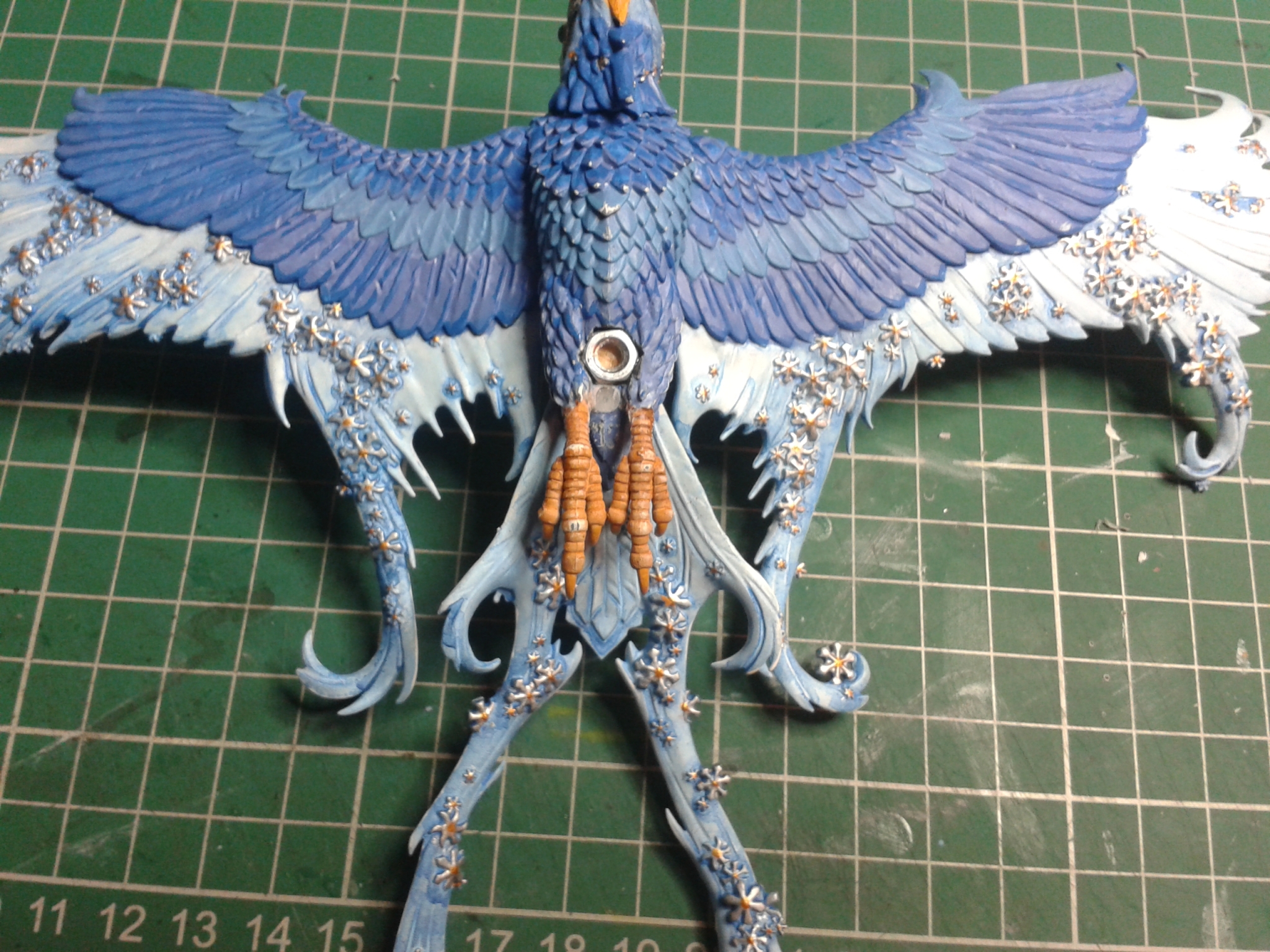

    I also did this for the Frost Phoenix of a friend. I had alot more work here to get the nut in properly because of the fact that the model is hollow. Had to fill up the hole properly first.
    Looks pretty good I think, but there are a couple of drawbacks. It takes some work and you can screw up easily by cutting away too much etc. The biggest drawback being that if I go too far while twisting to get the screw in the nut that the screw will push the nut away from the model. Superglue and GS will crack really easily if you tighten the screw/nut combination too hard.
    What do you guys think?

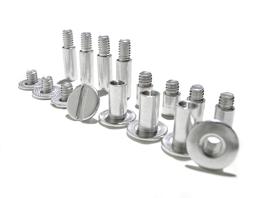

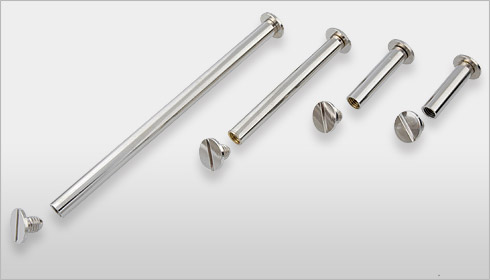

  14. pendrake
    5,024
    SCREWPOSTS aka Aluminum Binding Screws. Printing and binding industry uses them.
    n810 likes this.
  15. Haemoglobin
    Haemoglobin 9th Age Army Support
    458
    141
    Dude those would actually be perfect. Gonna have to do some research.
  16. pendrake
    5,024
    I know for a fact they exist at 3 inches tall. I have some. (Like 2-3.) I got them for the same purpose.
