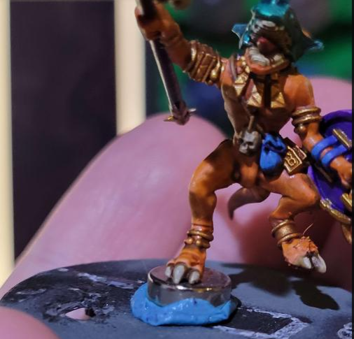

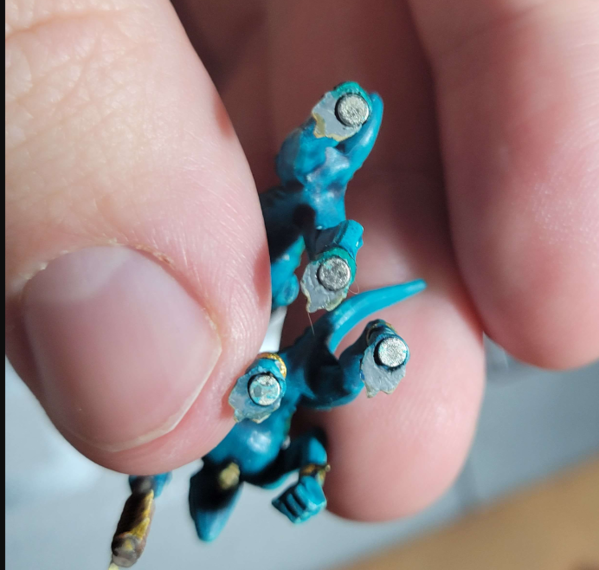

    Magnetizing the skinks
    Use your drill bit to drill holes in the feet of your priest and chief. Be careful as if you drill too far, you'll go right through the foot. The magnets might not fit fully in the foot, but this is OK, as it will only hang out maybe 20% of a mm out. Sometimes the foot might separate a little, but this is OK as it's hardly visible, and can sometimes be fixed with a bit of greenstuff.
    When you're ready to insert your remember to place your smaller magnet onto your reference magnet. The reference magnet will be as if its in your howdah, so make sure your skink magnet is on the reference BEFORE gluing. Sometimes I like to put a small bit of super glue on the skink magnet after placing it on the reference, then slot the drilled hole over the skink magnet, so I know for a fact it's how I want it.
    In this image, magnets are in both feet, and are sticking how I want them too according to the reference base
    Skink bow operator
    For this skink, you only need a magnet in his back right foot, as we'll be putting in magnets in the front of the crossbow.
    Remaining crew
    Drill holes in both feet and apply magnets.

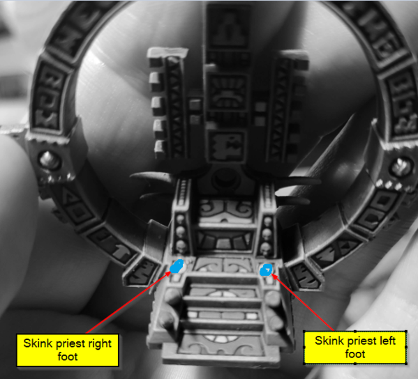

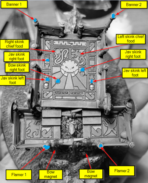

    The Howdah/Stegadon

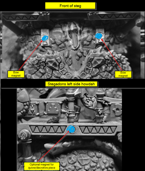

    Apply your magnets as follows. Remember to use your reference!

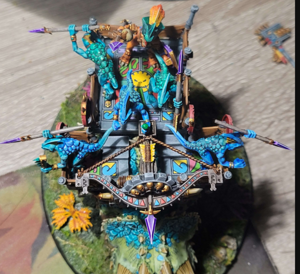

    When you've magnetized your howdah
    , it will look like this without the skinks (remember, we're gluing on two long tailed skinks)
    With all magnetized skinks

    For the front, I added in two for the feet of the skink priest. As to why I didn't glue it: I can put the skink priest on a separate base for game or display purposes.

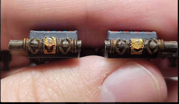

    Flag poles (optional)
    I only magnetized these for transportation purposes. This is a skippable option. I shaved down the connecting pieces for the flags and added the magnets. In the future, I'm wondering if it would be better to glue them together then snip them to

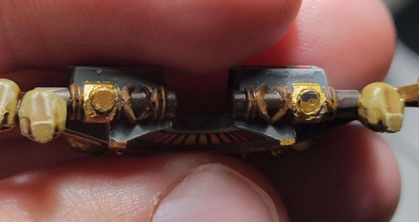

    Crossbow
    Two magnets in the metallic parts.

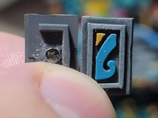

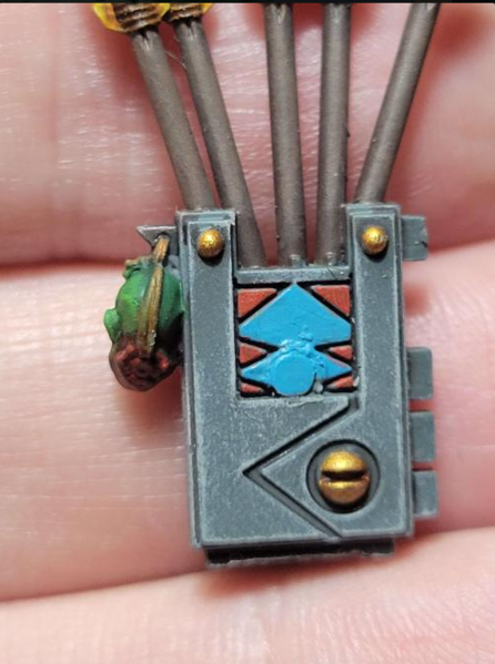

    Decorative side panel (optional, used for when we want the Engine of the Gods loadout)
    Crest for Engine.
    Flame spitters

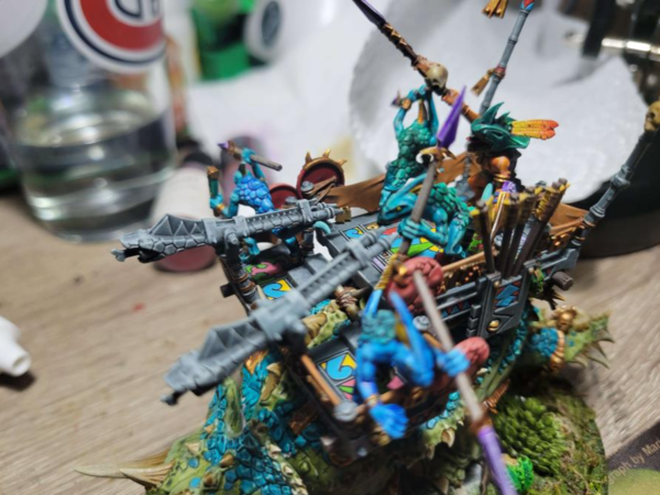

    Stegadon with bow
    Stegadon with Flame throwers
    Engine of the Gods
