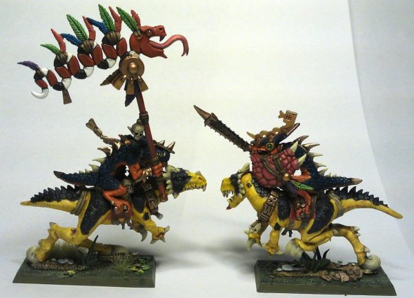

    I usually do it like this:
    First, base brown (I use the old Khemri Brown)
    Then, from 2/3 from base I use greyish brown (old Chardon Granite or something like that)
    Finally, from 1/3 from the point I use Bone White.
    Looks pretty good without washes, but if you want to go one step further, you could dilute your wash to 1:3 or 1:4 with water and then paint the whole thing from top to base, leaving most of the wash to the base of the bone. Then, after it had tried, paint again, but start from little closer to the base. Continue this until you reach the base. Addition of black wash at the very base to act as a shadow is a very nice trick, like n810 suggested.
    I also tried a different approach with the claws of my Cold Ones. I painted the claws brown and then diluted bone white to 1:10 or so, so really dilute, with water. Then I did the same layering as above, but started about 1/4 from the base and moved towards the tip. This is really a lot of work, but looks nice. Here's a picture for reference:
    Good luck with your painting!
