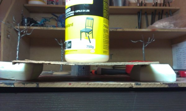

    Thanks. I actually saw it in the how to build scenery book from GW. For the other trees I calculated I need 30 meters of wire :grumpy: :hungover:

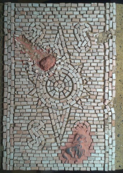

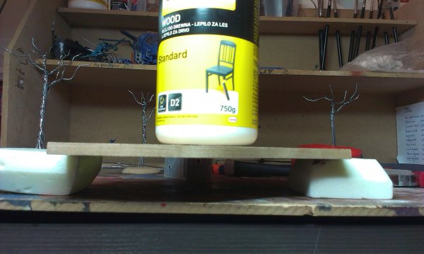

    Hey guys here a little update for you. I didn´t really have time to do anything this weekend as I have a history test tomorrow. :confused:
    As you can see I´ve added sand in between the cracks. When I started doing it I decided applying PVA by bush would be a nightmare, as the brush wouldn't fit in between, so what I did was pour very watered down PVA onto it so it would naturally flow by itself. The problem was that there were some areas where the PVA accumulated, and when I poured all my sand on top it soaked the PVA in, and so patches of sand have formed. Does it look odd? At first, I thought it looked horrible but now I´m kind of thinking that that could actually happen, so I don't know if I should leave it as it is or scratch it off.
    The trees have not received any further advance as I ran out of wire and couldn't find any in the 4 building stores I went to. So I´ll have to wait until I find out how to get some to continue the trees.

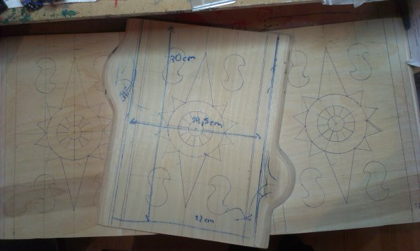

    I started to plan the next 3 path sections, just drew the image. I didn´t start yet the river crossing one, I´ll do it once I have both the paths and the rivers done.
    Ignore the measurements on the middle path (they´re wrong). I have to ask you guys if you have any ideas or suggestions for breaking the monotony of the path, just like I did with the previous one with the catapult stone and dead horse. I have already thought about making some fireplace or a pile of weapons, but that´s it. I have lizardmen bits, a box of skeleton warriors and the empire men that look like pirates, which I bought to put dead on the scenery, so feel free to include them in the ideas :p. I´m trying to keep this details low-lying so the troops can still be placed on them, so nothing higher than 1cm (about 1/3 inch).
    I came across another problem that will slow this down: I ran out of stones and went to the shop to get some more and there weren´t any, so I´ll have to wait until they get some more :confused:.
    Until then, I don't know what to do. I may start with the other scenery. I´ll see.

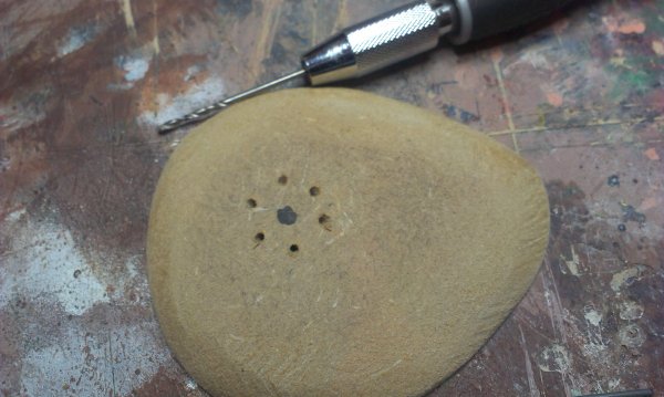

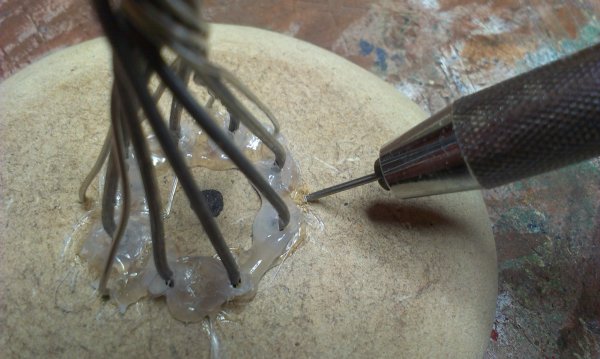

    So next, once you have cut out the bases (I used a jigsaw) and have
    bevelled them however you want them, mark where you want the centre of the tree to be placed and drill out holes at angle so when you turn around the wires they won't fall off (you can also glue them, but I'm impatient and the superglue didn´t dry fast enough ;)). I recommend the angle to be maximum 45º from the horizontal line (never steeper or the wires won´t hold). As this is the basic structure I used the 1.5mm drill.
    As you can see I drilled out 6 holes trying to make them lie on the same distance from the tree centre. I made 4 holes for the small tree, 6 for the medium and 8 for the big one. These amounts are both for support strength and thickness. Then I inserted the wires: 12cm-long for small, 15cm for medium and 18cm for big (I´d vary these lengths just a bit to make uneven trees).
    [Here you can see what I meant by drilling at an angle, although I made it way too steep and now I can take the trees off if I pull, so make sure you do it right because It´ll become a pain if it moves later on]

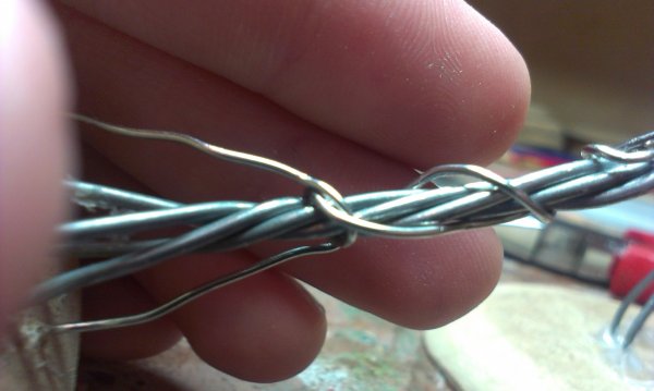

    So next is bend them together and once they are close take all the tips with the clippers and hold them in place while you turn the base around until you feel you have a strong tree trunk (usually when it doesn´t turn anymore :D). Note that the wires should be rolled to the tip, so when you unroll them to make the branches you will get more natural shapes. About the branches, I would make no less than 3 main branches and no more than 5. What I did is roll two wires together to make a main branch and then stop halfway and shape each separately to make the main branch divide onto two secondary branches. I recommend to search pictures of branches to try to make natural shapes (diagrams are very useful as they usually show the branches through the leaves).

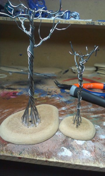

    This is what I mean: they start separating from the trunk and gradually get ¨flat¨, not going out the trunk perpendicular (which was what I tried first and looked so bad).
    As you can see in the picture below my branches don´t really follow the pattern I just described, but I´ll solve it once I get the clay on it.
    I hope you can see the ¨main¨ branches and the secondary.
