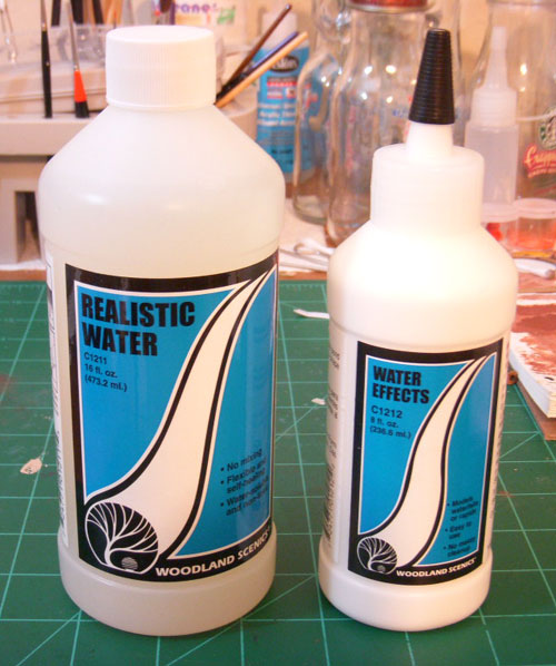

    Holy crap! I would have to say return that bottle if you can or get a new one! I use the woodland scenic products all the time, both realistic water and water effects. It is supposed to harden. Also you may be using "water effects" in too thick of layers. You should be using realistic water as your base and putting water effects(mixed with paint" on top of it for texture. I can see a half inch or more layer of "water effects" not drying ever. But quarter inch layers of realistic water should be hard enough to add to after 8 hours. Half inch layers should be completely hard(Thick layers can cause bubbles.) in 24 hours.
    It should be so hard in fact that I have actually dropped one of my water based models and chipped and scratched the water effects so now it looks more like cracking ice.
    I hope you used the stuff on the left.
    Also did it at least turn clear? If it is foggy it is most diffidently not dry and probably never will.
    Pretty shitty picture, but you can see it here on the base.
