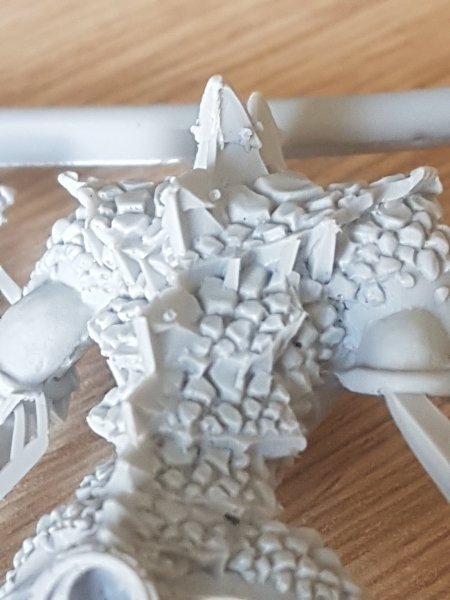

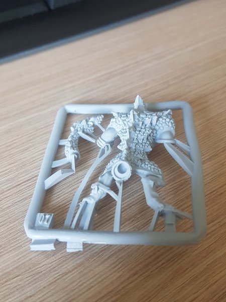

    Bought my first resin models (eternity warden and 3 kroxigor) and really struggling with getting them off of their sprues. In particular the resin bits that are connected to the model in between scales between the ridge plates on the back.

    yeah that is one of the 2 big problems with the krox models. it took me a good 2 hours to clean mine up using a exacto knife and clippers

    I haven't done the resin kroxs, but I have had minis like that. I'd suggest using a craft knife to cut it away, but do it in stages like you were slowly peeling butter out of the pot, taking it a sliver at a time so that the angle isn't too steep. It should make it less likely that you'll gouge into the model and as you cut away the more accessible parts you'll be able to angle the next cut more favorably.

    Aha yeah the legs are more an aesthetic criticism. Have gotten everything off the sprues but still will probably be another hour trying to file down the sprue lines on the backs. Also im worried af about trimming too much off of the spikes on the round weapon - the excess mould lines are so thick that if I trim them off the spikes would be disproportionately small :(

    There's been quite a bit of this - I spent ages on google trying to find pictures of the krox from all different angles and every direction etc. One example is the cords wrapped around the arms of one of them - there was residue attached to every part of it, often at intersecting angles, so I basically had to guess where the cord supposedly ended and the sprue began.
