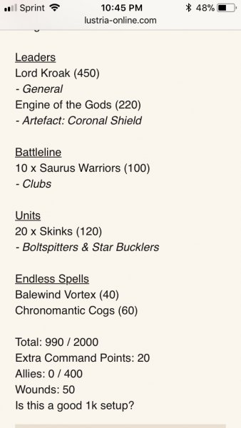

  9. DeathBringer125
    1,222
    3,201
    That a really cool build but I don’t have scar vet on cold one lol. Also I mostly play 1k point games so I have enough guys to summon. I use this build below and it worked well.
  10. GuaDan
    GuaDan Well-Known Member
    291
    501
    Stick a shield with blu tack on your Oldblood and voila.
  11. DeathBringer125
    1,222
    3,201
  12. Crowsfoot
    14,490
    Just use one knight from your 8 and like @GuaDan says give him something to stand out
