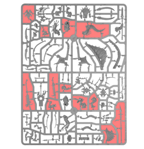

    • and the plastic bits shown below
    Pieces used from the Carnosaur Kit (You can use the alternate heads, chest plates and head top options):
    Pieces used from the Saurus Knight kit:

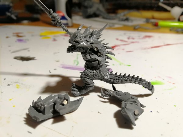

    So also started to magnetize my carnosaur and now want to share some images (Quality of the images is not the best).
    First of all a picture of the tools i used:
    A cordless screwdriver with a 2mm head to drill, superglue with a pointy nose, 2x1mm neodymium magnets, something to pre-prick the holes before drilling, a sharp knife to cut some stuff away and a pair of tweezers(which wasnt that useful because its magnetic).
    And thats basicly how it looks like if i put the parts that i have magnetized so far together:
    Another picture how it looks like with the "ground"-legs:
    Here you can see the different parts and where i put my magnets in (the body has obviously also 1 magnet at each side for the leg):
    I am not 100% satisfied with the result because of these gaps, but overall it it turned out good and the magnets are holding the parts great.
    Whats missing is the left arm and i am not sure right now how to magnetize this arm because its hard to find a good position for the magnet.[​IMG]
    For the right arm i will probably just glue on the sunstone spear. But if not its not that hard to magnetize the arm and the different weapons.

  15. Seraphage

    UPDATE:
    After three attempts to glue the magnet i managed to magnetize the left arm as well.
    the existing gap is really small thanks to the little overhang of the arm.
