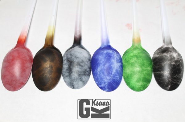

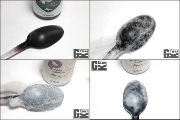

    So this is a random find on the internet, but anyone ever experiment making marble effects with what looks like cotton balls?
    Unfortunately I do not speak nor read Russian, but from what I can gather in the pictures that looks like airbrush paint? Seems like a simple method; pull a bit of cotton ball over a lightly-based object/model part, spray, then remove cotton swab pieces for a nice marble effect.

    FireShot Capture 057 - Ideas for HA - imitation of marble, minerals, blood vessels.png

    I wonder if it's even remotely doable without using an airbrush
    BigDinosaur, Warden and Erta Wanderer like this.
  5. Crowsfoot
    No chance, you need a very fine spray so it does not coat the cotton too much.
