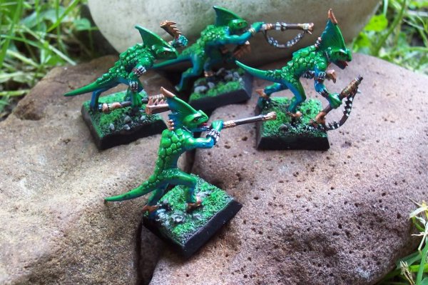

    Pps. after all this talk I should probably post an example of the results. :D

    Your skinks look great, dude, well done. I have to admit though, the eyes are a bit difficult to see, but I think I get the gist of it.
    Did you paint small reflection dots? and did you use 'Ardcoat?
  8. n810
    6,522
    yea they have some sort of clear gloss coating... probably Krylon.
