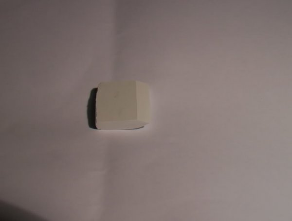

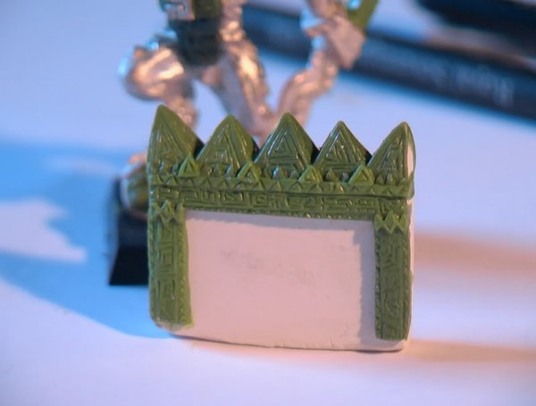

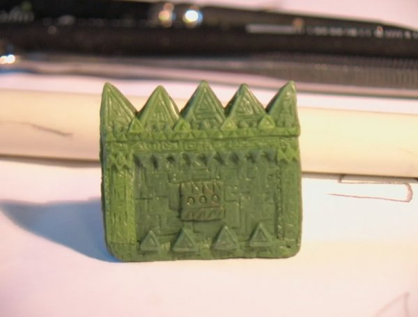

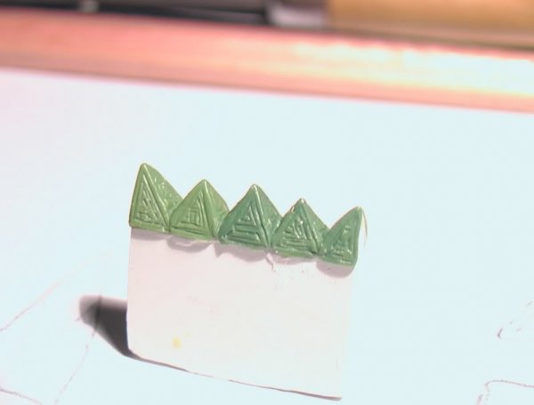

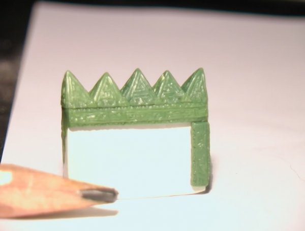

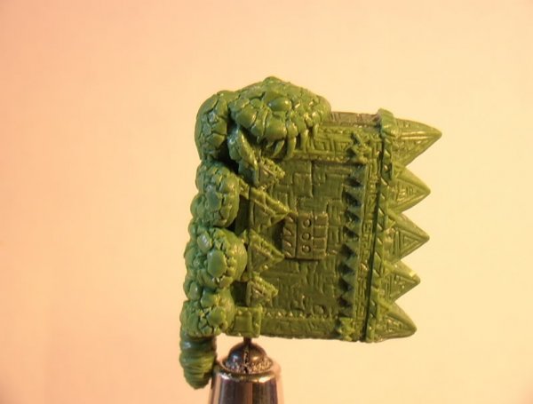

    Layering is where you build up slowly in detail bit by bit allowing the stage before to dry or even completely harden before you move on to sculpt the next bit. Like I said earlier nothing is sculpted in one go and so knowing what should be paced out is a good place to start as it makes your job as the sculptor SO much easier. Below are just a few examples of layering so you can get a good idea of just what I mean as with each of these stages the putty has been allowed to completely harden so if I touch it the detail will not smudge. Obviously these photos where not taken at every single stage of sculpting but again its simply there to help give you an idea of how to build up. (Click for larger images.)

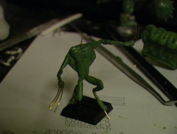

    Ok some of you may be wondering what exactly is an armature? The simple answer is an armature is a skeleton frame made up of wire with some green stuff lightly spread over it to give it shape, strength and soemthign for your green stuff to cling to. Below is an example from a Strigoi sculpt I am also working on. (Click for larger image)
