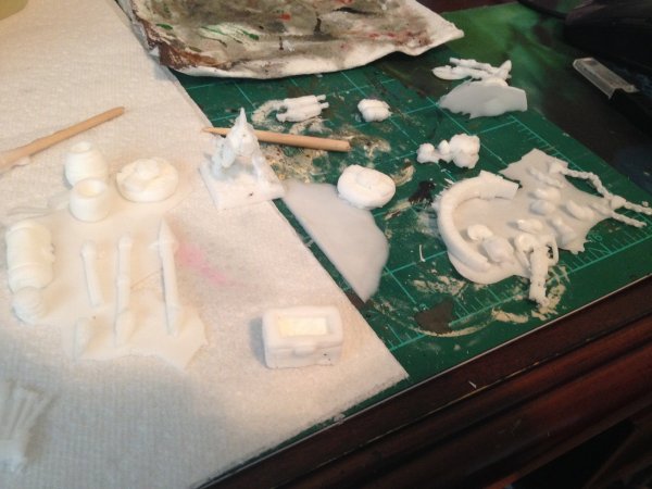

    Works really great, the molds come out pinkish white:

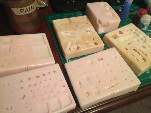

    They are designed to cast resin made by the same company. Really simple to use, I have experimented a few times using this stuff for minis and terrain.
    Word of caution: do not expect super tiny pieces to cast well, such as thin weapons (spears/blowpipes) or the little spikes on the back of a saurus or the head-crest of a skink. Without injecting the resin into the molds, there is nothing from stopping air bubbles from arising on your minis. You may need to go over the resin-cast products you make with green stuff/clay to fill in the tiny holes and/or fix the casting errors that will inevitably result.
    That being said, I have really liked this process, as it allows me to cast large pieces for terrain and some mini bodies, that allow me to make use of all those extra arms/weapons/heads that seem to come in miniature packages with not enough bodies to go around.
