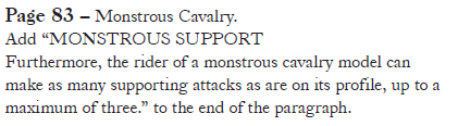

    I thought they could, given they are Monstrous Cavalry? Certainly the riders would get to make their full supporting attacks in the way Monstrous Infantry do, even if the mounts don't as with cavalry?

    I've checked the BRB and welcome any review of it I've missed, but on Monstrous Cavalry it doesn't say anything about being able to do full set of attacks.

    @Lord Agragax of Lunaxoatl is correct.
    The mounts don't get to make any supporting attacks...
    "All the cavalry rules apply to monstrous cavalry..." [BRB, page 83]
    "When a cavalry model makes supporting attacks, only the rider can strike - we assume that the mount lacks both he discipline and the reach to fight through those ahead of it." [BRB, page 82]
    The riders do indeed get to make a full set of attacks (up to a maximum of 3) as per the ERRATA:
