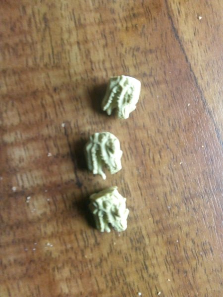

  5. Irish Lizarman
    Irish Lizarman Well-Known Member
    188
    273
    Hey guys I;ve just after getting some blue-stuff to cast some of the non derpy kroxigor heads but im having terrible trouble getting the top half of the mold right any tips? I've tried following the videos online and my results are never the same thank you also could i cast with Fimo?i think it might me more durable when baked

  7. Aginor
    20,175
    I used the air drying Fimo variant, it works decently.
    The problem with the baking is that the mould will not take the heat. So unless you let it dry a bit normally, take it out of the mould and _then_ bake it that will not work.
    Can you describe the top half mould problem a bit more precisely? In which way does it not work?
    Irish Lizarman likes this.
  8. Irish Lizarman
    188
    273
    it seems the top mold isn't deep enough when i make it friends have said its just trial an error but any tips are most welcome so there is more material on on side of the cast than the other
    Aginor likes this.

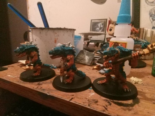

  9. Irish Lizarman
    188
    273
    So i managed to figure it out i had to make single piece molds a few miscasts later and boom kroxigors with less derpy heads
