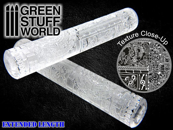

    Hey guys? Does anybody know any good resources for making temple ruins for terrain and basing uses? Be it sculpting your own, or using certain rolling pins and putty (cuz I know there are some, but are they good?)

    If you need ornaments you can use the rolling pins from greenstuffworld.com
    Edit. Sniped, I have exactly that rolling pin.
    Roll them over some putty or so, I use the (non toxic, BPA free) "fimo air basic". It is similar to clay and works great.

    Is it easy to work with green stuff like that? I imagine you'd have to use a lot of water...

    Those rollers look amazing! How have I not heard of these guys before? XD

    I use DAS air drying modelling clay. 8 billion times easier to work with than green stuff.

    Yeah green stuff is not ideal for that.
    It behaves weirdly when you use large amounts, it is expensive, and toxic.
    My friend tried brown stuff and it wasn't better either.
    That Fimo stuff I use is mineralic, and so is the one @Ritual mentioned IIRC.
    You could even use plaster I think. People make rocks out of it when making model train terrain.
