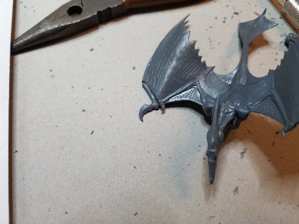

    First I'll tell you what won't work:
    1: swapping the claws on the wings. You will have to choose between the Ripper Claws (one big, claw on each wing) or Terradon Claws (two smaller ones). I would probably choose Ripper claws but it really is up to you. Those parts are too thin to magnetize but at least both fit to both variants and both look cool.
    2: The ring around the neck to which the rider is attached. It is impossible to remove it from the neck once you attached it (it is too small to slip it over the wider part of the neck). There are a few possible ways around that problem but probably the easiest way is to get a small metal or plastic ring from a craft store, or make one yourself out of... wood or green stuff or something.
    I have a possible way around that problem but I'll have to see whether my idea works. More about that later.
    3: You will probably have to replace the transparent rods or get three additional ones from somewhere, as it is difficult to attach them to the body without glueing them on. Not impossible though so you might make it happen.
    No problem for me since I was going to replace them with steel anyway like I did with my other Terradons.
    Those are the only problems I still see.

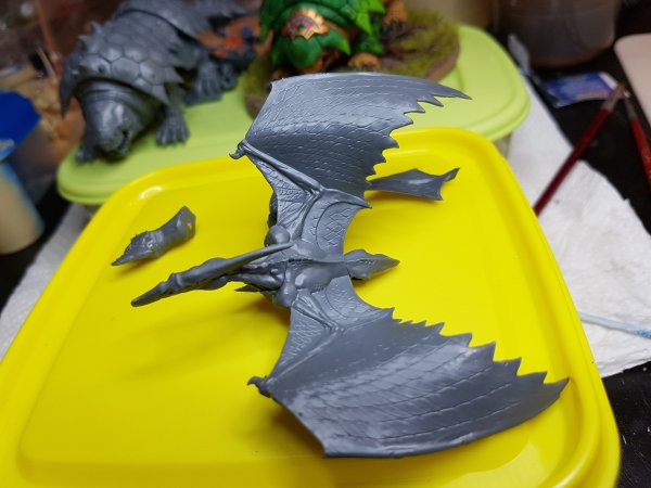

    Rough assembly for the bodies as far as I can tell right now:
    - Assemble the head and the neck of both versions.
    - put the body together but do not glue the neck or tail to it. EDIT: thats actually a bad advice. You should probably place the rear facing magnet first, see my post below.
    - glue the legs to the tails.
    - choose which claws you want for the wings and glue them on.
    - don't attach the rings yet
    That's pretty much it. Next is the magnets.

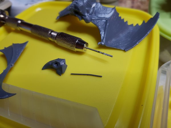

    Ok I think I have figured the tail thing out.
    Remember the Microsoft Office Assistant (Clippy in English, Karl Klammer in German)?
    He is here to help you!
    ...you just have to kill him and cut his corpse apart to use it as a support structure! :D
    Ok seriously. I just tried it. I drilled small holes (a few mm deep) into both tails to stick a paper clip part into it. It works.
    The holes don't have to be perfectly centered, just identical for both tails. Then use one of the tails to find the right position and glue the paper clip part into the body.
    Remember to leave enough space for the magnet to fit into the middle of the tail.
    Here are a few shots. Not perfect since it is my first try. I think Ill try and put it together and see if it works or if I have to try something else.

    I assembled the heads and tails and it looks decent.
    I messed up the rear end a bit so I will need some putty to fill the gap. Not severe but I think I can do better so the junction is barely visible.
    I will also try and cover up in that area with the paint job.
    Now I am contemplating which claws to use...
    Originally I wanted to use the Ripper claws but now that I see it....
    I think the smaller (Terradon) ones look better if you take into account that they must fit both variants.
    IMO the Terradon claws look less impressive but OK on the Ripper and I can imagine that it can slash with those as well, while the Ripper claws look a bit out of place on the Terradon...
  20. Aginor
    20,161
    So.. any opinions on the claws?
