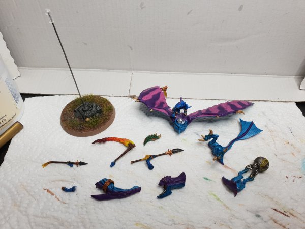

    I finished them (well.... almost) and here are some pictures and explanations:
    First of all: All the parts of one model.
    and another shot in which you can see most of the magnet locations.
    The rider is glued to the mount in a way so he doesn't prevent the head from being attached.
    You will also notice that I marked the parts with a black marker (in this case an "I" so I see which parts belong to which model) 20180921_194829.jpg
    The assembled Terradon with the Bola....
    The arm is slightly longer because it isn't thick enough to drill a hole for the magnet into it. So I just painted one magnet bronze like the wrist band, and one blue like the arm. 20180921_195035.jpg
    ...and with the Javelin.
    I messed up the shoulder a bit, and the model has a few visible seams. On the table they are almost invisible though.
    The little square metal part on the arm is the sawblade part for the Ripper rider's shield to attach to.
    The Skink's arm is not attached to the ring naturally, but it is assembled in a way so it looks like it is, at least from most angles.
    Keep in mind that most of the time that model is viewed from above. So if it doesn't fit perfectly seen from below that isn't as severe.

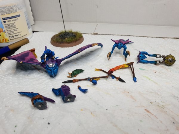

  2. Aginor
    20,175
    And here is the Ripper.
    As mentioned earlier the Ripper has the Terradon claws on the wings. It is not impossible to make them interchangeable, but it is tedious and IMO not worth it.
    And lastly here are some more detail pictures of some of the attachable parts:
    20180921_200325.jpg 20180921_200344.jpg 20180921_200334.jpg 20180921_200747.jpg
    The flying stand is made of a metal rod, and I sawed off the tip of the original part.
    It is not glued in, the tail parts just have a small ball of poster putty in them.
    So I hope this helps if you want to build convertible Terradons/Rippers yourselves.
    If you have questions, just ask. :)

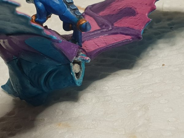

  14. Imrahil
    14,215
    27,759
    Here is my attempt at assembling
    Now I have some progress to show:
    I magnetized them so I can change between the Terradon or the Ripperdactyl. I have done just one for now. I used magnets between all part. between the tail and the body there is also a iron pin to strengthen the body once build and on the stake. [​IMG]
    For the Shield I cut away the middle 'spike' on the arm and drilled a hole with a cut off paperclip, then inserted a Tiny piece of paperclip. So without a shield it looks just like the normale spike. In the Shield I used a magnet.
    Here are all the pieces apart:
    I still need to add the collar to the Teradons neck and then glue the body of the skink to the body of the 'Bird'
    Ryanj4043 and Aginor like this.
