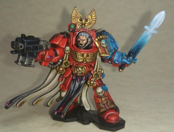

    For blending I generally get better results with the medium. That's only my opinion and plenty of people use water but since trying the medium extender I'm totally sold on them. If I'm doing a large area or I want a very think colour, I might use water. For example on this sword, I used a mixture of 1:3 paint/water rather than using medium.
