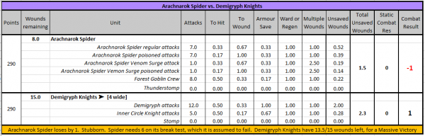

    Matchup time! This time around we have Australia's champion, the Arachnarok Spider vs. the Empire's Demigryph Knights.
    Before we begin, the Arachnarok Spider has two special rules that greatly complicate the calculations. I will try to explain how the calculations were performed. The two rules I speak of are the Spider's Poisoned Attacks and its Venom Surge.
    The Spider has 8 total attacks (+crew attacks). One of those attacks is nominated as the Venom Surge attack, which has the Multiple Wounds (D6) special rule. So I split the Spider's attacks across two excel lines, one containing the 7 regular attacks and one containing the 1 Venom Surge attack. Simple enough so far... but wait there is more! Both the regular attacks and the Venom Surge attack has a chance to roll a 6 for a Poisoned hits or roll a 4 or a 5 for a non-poisoned hits. So those two excel lines [1 for regular attacks and 1 for Venom Surge attack] each have to be further split in two, accounting for hits and poisoned hits. So the Spider's attacks (just the Spider, the crew have their own set of attacks) are accounted for across the following four lines on the spreadsheet:
    • Arachnarok Spider regular attacks
    • Arachnarok Spider poisoned attacks
    • Arachnarok Spider Venom Surge attack
    • Arachnarok Spider Vemon Surge poisoned attack
    So for the 7 regular attacks, we have two lines, accounting for poison and non poison. You'll notice that each line has a 7 under the attacks column. The reason for this is because it is accounted for under the "To Hit" column. The Spider and the Demigryph Knights each have WS4, so the Spider is hitting on 4's, 5's and 6's. The rolls of 4's and 5's represent non-poisoned hits, while the rolls of 6's represent poisoned hits.
    The odds of rolling a 4 or a 5 is 1/3 = 0.33 (which is the number we see in the To Hit column for the "Arachnarok Spider regular attacks")
    The odds of rolling a 6 is 1/6 = 0.17 (which is the number we see in the To Hit column for the Arachnarok Spider poisoned attacks)
    So even though the Spider looks to have twice as many attacks, it is simply because the hit probability of 50% is spread across two lines, 17% + 33% = 50%.
    The same procedure is applied to the Venom Surge attack and the Venom Surge poisoned attack, but this time with only 1 attack instead of 7 (as described previously).
    Hopefully this is making sense. I have only one more thing to explain, namely, how to deal with Multiple Wounds (D6). You'll notice in the table that there is a Multiple Wounds column, and under it I have calculated the D6 wounds to be 2.5 (and not the 3.5 that we would normally expect as an average of D6). The reason for this comes down to how the Multiple Wounds special rule works. On page 45 of the BRB it states in reference to Multiple Wound models and Multiple Wound weapons that: "remember that each model cannot suffer more wounds than is on its profile). In this case, we have Demigryph Knights, who have 3 wounds on their profile. Therefore, if when rolling for our Multiple Wounds (D6) we roll a 4, 5 or a 6, these only count as "3".
    So when rolling Multiple Wounds (D6) we can roll either a
    • 1, 2, 3, 4, 5 or 6
    • which in game terms means 1, 2, 3, 4➝3, 5➝3 or 6➝3.
    • so we are left with the following possible outcomes 1,2,3,3,3,3
    • when we average these numbers we get (1+2+3+3+3+3)/6 = 2.5
    And that is why you'll find the value of 2.5 under the Spider's Venom Surge Multiple Wounds table column.
    Hopefully that made sense. Please let me know if any of this is even remotely useful. It is exceedingly boring to type out (and probably not much more interesting to read), so if nobody is reading it, I can save myself a bunch of time when I tackle the Soul Grinder and the Hell Pit in the future... each of which have different rules to account for.
    With that out of the way, now let's move onto the good stuff...
    Key rules in play:
    • Demigryph Knights: Armour Piercing (Demi only)
    • Arachnarok: Poisoned Attacks (Spider only), Vemon Surge, Stubborn
    Both units had a great deal of difficulty wounding each other. The mighty 1+ armour save protecting the Demigryph Knights and the toughness of 6 protecting the Archnarok. In the end, the Demigryphs were able to wound just enough to swing combat their way. This is where the rules of our tournament hurt the Spider. For break tests, we assume that units roll 7 (which is the most probable roll). The Arachnarok only has leadership 6, so anytime it loses a round of combat it will break according to our rules (the Chaos Trolls suffer from this same fate as well). Of course, even if we were to assume that the Arachnarok made everyone of its break tests (which is extremely unlikely in an actual game without the general's leadership bubble) it would still be wiped out by the Demigryph Knights, only instead of 1 round, it would on average last 4 rounds.
    As per usual, here is the updated table:
    Most importantly... Thoughts? Concerns? Discussion!! :)

    First off, may I just say again that I appreciate you doing all the mind-numbing calculations. I think you make good sense on what you worked out.
    Second, I did not see that coming. I thought the Demi-Gryph Knights were one of the contenders for last place. This example truly shows that power of the 1+ save. Absolutely brutal!
    Makes me feel better about going up against the Arachnarok to be honest!

    Demigryph Knights are essentially Skullcrushers lite. Skullcrushers are obviously a fair bit stronger, but they also cost a fair bit more.
    It's still a very good unit. It barely lost combat against Demigryph Knights (it only lost by 0.8 wounds)! I'm curious to see how it will perform against some of the softer targets on our list.
    Remember that all of these competitors are the best of the best, so the Arachnarok can still do well in real game scenarios against regular units. It does show though that the the Arachnarok really needs the general around.

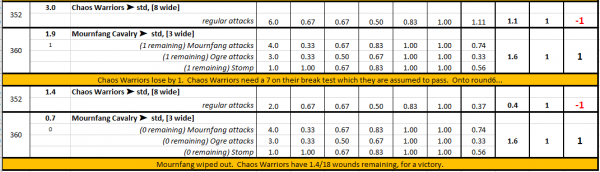

    Up next... Chaos Warriors vs. Mournfang Cavalry.
    Running the Mournfang 5 wide results in them sustaining 6.2 unsaved wounds (before they get to strike) killing two Mounfang models. In the previous scenario, where they were run 3 wide, they sustained only 5.3 wounds, which is rounded down to 5. Meaning that instead of losing two models, they lose 1 model, and the second one is sitting on a single wound. This increases their counterattack slightly, but more importantly it swings the combat from them losing combat by 1 (and breaking) to a drawn combat.
    So the Chaos Warriors squeak out a massive victory. The contest is a lot closer than it appears on paper and can swing pretty wildly. I would like to add a caveat to the results. In game terms, the contest would come down to who gets the charge. If the Mournfang get the charge (especially if running 5 wide), the impact hits alone will average 5.6 unsaved wounds (before the Chaos Warriors get to strike) and swings the contest in favour of the Mournfang. However, as per the contest rules, the Warriors of Chaos take the victory.
    CORRECTION - The Mournfang Cavalry's ability to parry save even while mounted was not originally factored into the calculations. The correction has been made below, as well as a small error on the Chaos Warriors number of attacks in one round.
    The previous Massive Victory by the Chaos Warriors has been downgraded to a hard fought last man standing Chaos Warrior Victory.
    Obviously, every single update table (up until the fourth round of the tournament, which is when I noticed the omission) will have the incorrect result for this matchup.

    To be honest, I was really hoping that the Mournfang Cavalry would win here but there is a reason why I put WoC as my bet for the win. Ridiculous.
    Like you say, the Mournfang charge is most important. In a 3-wide unit, that's 3D3 S5 impact hits. Makes a big difference and I genuinely would think that if a WoC unit got the charge, then unless I was pretty lucky I would lose for sure (or get some kind of flanking attack).
    The WoC army list is super depressing when viewed in isolation like this. Gaaagh!
