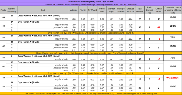

    In the Skeleton Chariot combat, the scenario assumed that the chariots had just charged into combat. This means they get impact hits. So in the first round of combat, the order of attacks are as follows:
    1. Impact hits from the Skeleton Chariots (which are resolved at the very beginning of the close combat)
    2. Chaos Warriors (striking at Initiative 5)
    3. Skeleton Charioteers AND Skeletal Steeds (striking at Initiative 2)
    So the small number you see in the wounds column of the Chaos Warriors represents the wounds they have remaining after the Skeleton Chariot impact hits are resolved. The small number is used in order to determine how many WC models are left alive to attack back. You'll notice that after the first round of combat, this small number is exactly the same as the wounds they enter the round of combat with because there are no Impact Hits in subsequent rounds of combat.
    The small number you see next to the wounds column of the Skeleton Chariots represents the wounds they have remaining after the Chaos Warriors have attacked. The remaining models then have an opportunity to attack back at their initiative of 2.

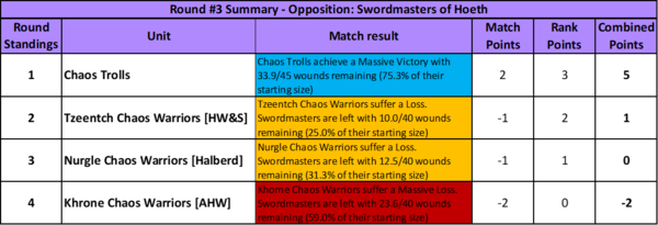

    The contest lasts one round longer, but the Swordmasters end up doing even less damage to the Trolls overall

    @Lord Agragax of Lunaxoatl : your High Elves cut through all three variants of the Chaos Warriors with ease. Do you still feel that they are an OP infantry choice? And if so, what does that make the High Elves?

    Hardly 'with ease'. The only variant they beat in any form of comfort is the Khorne Warriors. I'll certainly admit that the Khorne build is not as strong as I first thought, though, it is easily the worst of the Warrior variants there.
    By contrast the other two whittle the Swordmasters down to around a quarter of their size, again rendering them easy to dispatch in the later game. That's definitely nothing to be sniffed at.
    My main argument was that they're an OP Core choice, and they (certainly the Tzeentch and Nurgle builds at least) still show themselves to be when they can take so much out of other armies' Special and Rare choices and render one of their own army's Special choices (Chosen) invalid.
    Though of course their power is nothing compared to that of Chaos Trolls. Normally of course they'd be countered by Stupidity but Throgg lead deals with that in the best possible way.
    You forget that Swordmasters are very easy to kill off with shooting attacks, significantly easier than any Chaos Warrior build (even Khorne Warriors have T4 to set them just above Swordmasters in durability, especially against the small-arms bowfire that most armies primarily use). T3 and a 5+ armour save are big inbuilt counters.
    And for the record, I only have 10 Swordmasters in my army, and am happy to keep it that way.

    Definitely not a K'daai Destroyer level of ease, but they still took out all three Chaos Warrior unit variants. The Chaos Warriors couldn't even win one of the three matches. For comparison, the Saurus Warriors were able to steal a win off of the Chaos Warriors. If we argue that the Swordmasters are not that much better than the CW, then we have to concede that the CW are not that much better than the Saurus Warriors.
    Despite the damage the Swordmasters sustained (25%, 31.3% and 59% of the unit remaining), the Chaos Warrior matchup is definitely a good one for them. In our Best Close Combat units in all of Warhammer tournament, we saw heaps of matchups that were much closer than this was.
    We'll see how many of the opponents' Special and Rare choices they can take out. Don't forget that the Nurgle Chaos Warriors finished in 15th place (out of 16) in our Best Close Combat units in all of Warhammer tournament. Admittedly those were some of the best of the best, but of their 15 matchups, they only managed to win 4 of them. For comparisons sake, they were outperformed by the other two core infantry choices in the Savage Orc Big'uns (who finished in 9th) and the mighty Witch Elves (who finished tied for 5th).

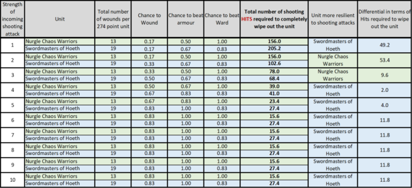

    As an example consider a 247 point unit of Swordmasters versus 247 point unit of Nurgle CW. Which is harder to remove off the table with shooting?...
    19 Swordmasters with T3, 5+ armour and 6+ ward
    or...
    13 Nurgle Chaos Warriors with T4, 4+ armour
    One last point, consider that the Swordmasters are essentially an off-meta pick for the High Elves. White Lions and Phoenix Guard seem far more popular, especially the latter with how well they synergize with the army.

    You've peaked my interest. Why speculate when we can simply run the numbers for a definitive answer?
    Swordmasters do better across the majority of the strength values, but Nurgle CW hold the advantage in terms of the very common S3 shooting attack. All things considered, they are fairly similar in terms of surviving shooting attacks.
