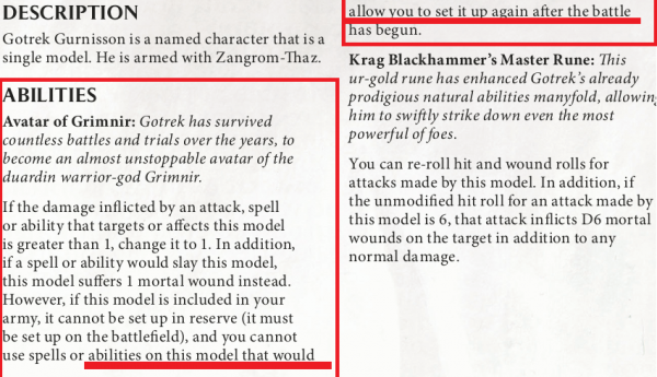

    Gotrek can not use any rules that reqiure him to be "set up". So this is sadly not allowed
    Tobi131313 likes this.

  8. Imrahil
    11,258
    24,021
    I would say this is the case:
  9. Tobi131313
    Tobi131313 Member
    49
    57
    Yeah, i did know about this, but i as i understood it, the garrison doesn't work with an ability but a core rule, and that's why i thought it would still be possible

  16. Putzfrau
    Putzfrau Well-Known Member
    2,235
    2,865
    Feels clearly unintended. He can't be "set up" after the game begins and when leaving a garrison you are "set up" within 6.
