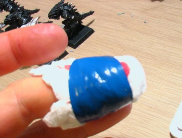

    Well a mate of mine also plays lizards and he's a huge fan of the comet, so he was having a rant about how it's always annoying using coins (especially as he needed the coin to go and get another packet of crisps).
    I had my green stuff there with me so started sculpting an appropriate marker, because gaming nights without crisps is like a lizardman list with no dinos, just a little disturbing... ;)

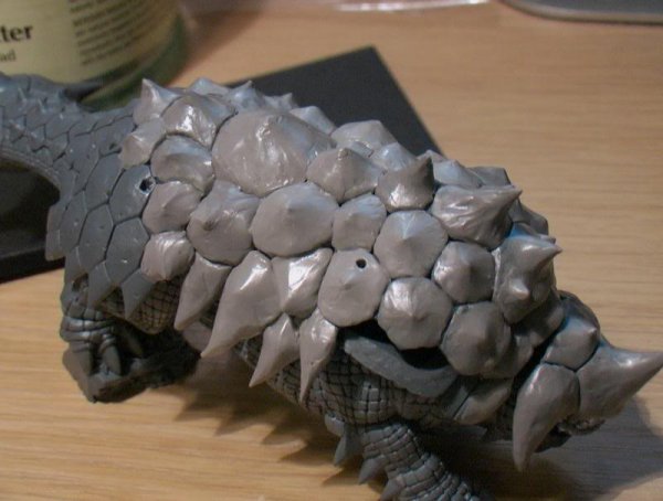

    So the bastilodon:
    It was much nicer than I expected when I opened the box and started gluing bits together, but I'm not sold on the detail, especially the scaled parts. For my tastes I find it too flat and smooth, making it look a bit more like a kinder egg snap kit. I can see the idea that GW has tried to use, it vaguely resembles a glyptodon with the bands, but they're just a bit too bold for my liking. So I break out the putty and get started...
    I should point out now however, that I made a huge mistake with much of this by using procreate putty, the putty I have is old and so it wasn't until near the end that I realised I needed to use green stuff instead. Best place to start is at the head and work back. I have chosen to include these mistakes however as it's always good to show that things never go exactly as you want from start to finish.
    As you can see, the putty is very tough, blocky and not really holding detail, ALL of this will have to go/be changed.
    I now work on covering the main area I'm not sold on, the massive gaps between different gluing points, my personal preference here, it's neither natural or at all organic in nature to my eyes.
    I also begin working on the side plates, these will be added later.

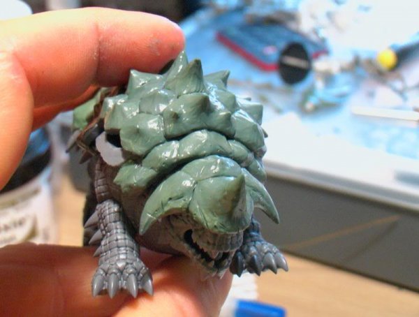

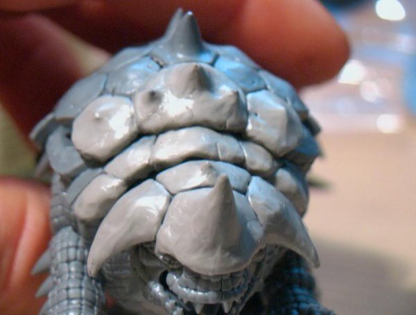

    First off, I had to back track considerably as I'm not a fan of pro-create, it just doesn't have the flexibility of GS when it comes to more organic shapes and isn't as pushed and pulled as easily.
    I had to re-do the bastilodon scales, I've almost finished, but need to finish the long shoulder spikes.

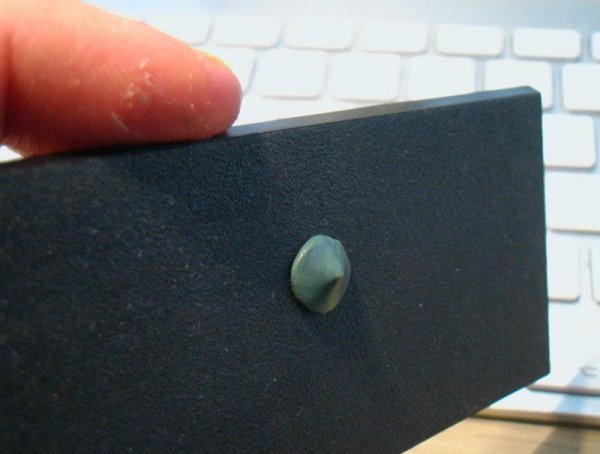

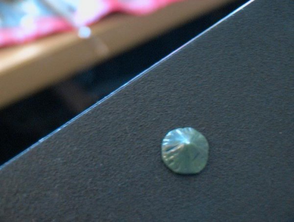

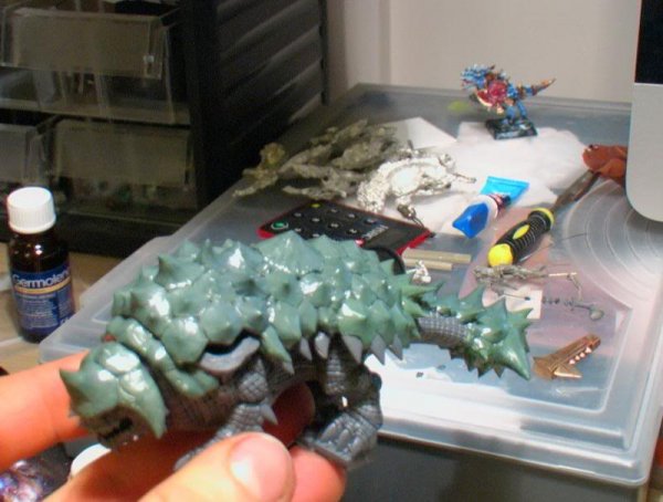

    Ok, got a quickish one fired up for you.
    I've included some of the tools I typically use.
    First thing is to obviously mix your green stuff and place it where you want it (on a tray for this tutorial purpose). Included is a flat tipped clay shaper, which will be used next.
    So the stage here is two fold with the flat clay shaper, the first is to push the material from the center out and down (but not right to the edge as it will make it go flat against the base, which is not what scales do, they are raised).
    Next I do the opposite by pulling with the clay shaper towards where I want the point (in this instance, it's in the center point up), to help create a raised area.
    I now use the bullet tipped shaper to pull the material towards the point, it's worth noting that you can press in a little deeper at the base, so long as the line you draw becomes thinner towards the point. I now get my pokey tool (real name not known) and my wax 5 to add in damage, scars and battle marks.
    Just as with painting, it should be worth nothing that excessive weathering and scaring helps to make a piece older/has seen more action in battle.
    Lizerd likes this.

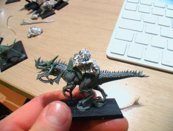

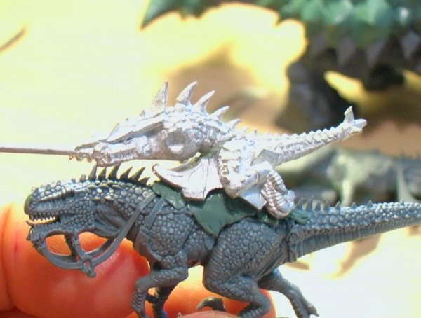

    A little later than I had hoped but I'm going to cover the cold one conversion progress here.
    So to begin with you obviously need some cold ones from the Dark Elves army box. If cost is an issue you can easily get them on Ebay.
    For the sake of my army and this topic I've chosen to use my old metal saurus cold one riders rather than the plastic ones, they give a better sense of the charge with their crouched positions.

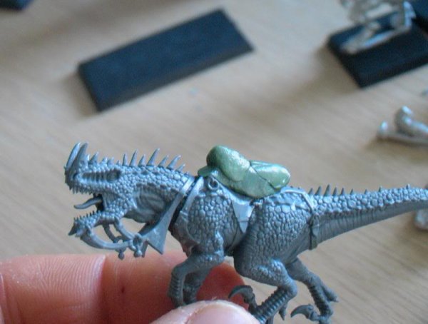

    So to begin with the saddles are the largest problem, easily solved though but using some clippers to snip the largest parts away. As you can see with the middle cold one I've done just that, cut the larger parts away and trimmed it as far back to the skin as I can.
    The top one as you can see has been trimmed back even further again, not only that I've cut back some of the more spiky dark elf parts, like the chest guard on the cold one.
    I would also like to take this step to give you a caution, BE CAREFUL WHEN TRIMMING WITH SCALPEL BLADES!
    Only ever take off small parts at a time, do not use the scalpel to take off large parts, otherwise this happens....
    Next up, I continue (as mentioned above) with the removal of the spiky parts of the DE cold one armour, but this is just my thing, I'm also trimming the flash and mould lines.
    I next add on the cold one rider, although there is a lot of space, this is easily filled with green stuff, I will be using it to make a layer of fur. So the first thing to do is to put a layer down and make a basic shape, as well as evening out the lumps.
    And finally I start to make the fur, I start at the edges and work backwards with a wax five (though any sharpish tool will do), remember that fur flows away from itself and does not form straight lines. This might well be as far as you wish to go, but I will be doing more work with this unit, both minor conversions and little additions, which you'll be able to see in the finished unit. :)
    To give you a little more variety in this piece, I will be using the champion cold one from the box set to make a Horned one for my scar vet. The processes will be the same as above, but with a little more variety, more armour and more decorations. I will happily post these too if you wish to see them.
    Coming next.....
    Razordon....scratch build....
    Lizerd and cwood92 like this.

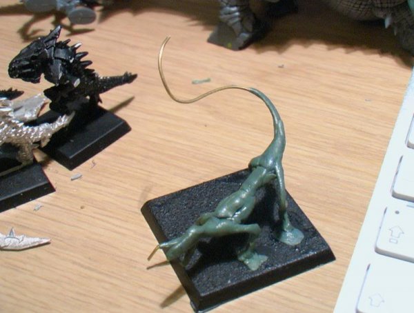

    I'd like to add at the start that I don't own a single Razordon mini, never have done either, I'm really not a fan of the design, but as I said at the start, this isn't meant to be a GW bashing thread, I'm just sharing with you my ideas and thoughts behind sculpts that I do.
    So speaking of thoughts I'd like to explain a little behind this armature.
    First off, what does a Razordon do?
    According to the fluff it flicks spines and spikes at its prey/foes, GW were even kind enough to provide some very nice artwork to give an example of what they were getting at.
    So, you have artwork and a detailed description of the beast and what it does, more than enough to make some detailed work.
    Razordon Anatomy:
    This next bit is the secondary stage, you know what a razordon does, what it looks like and how it behaves, so now you need to make some conclusions of what it's anatomy needs to do to fill the description, this goes back to my first question, what does a Razordon do?
    A: It flicks spines at foes with its tail.
    So this builds on that answer, you know what it does, so you must then figure out what it needs in order to be able to do this....
    -It needs a long, flexible tail. No point in a short stubby one, you need something that works like a whip in order to flick spikes at speed and distance at an enemy.
    -It needs to have longer back legs. No point having longer front legs as it makes it harder to flick spines over your head, especially given the benefit they get from shooting at a charging enemy, you need to be able to see it coming for you as well as the ease of firing at it.
    -It needs highly mobile limbs. Flicking spikes, with the aid of a long tail means you're going to have a lot of force generate by this flick, more than enough to knock you off balance, which is rather counter productive if you fall over every time you do it. Hardly useful for any kind of use as it would leave you very vulnerable.
    The way around this is to have a good deal of mobility with your legs, a low squat with the body to reduce your center of gravity and your limbs splayed to spread your weight and reduce the chances of being knocked off balance (especially on the side you have your tail, if you're not going to flick it directly overhead).
    Put all this together and it gives you this....
    Nothing to look at, at the moment, but everything I've mentioned above is there, greater spread on the legs on the side where the weight of the tail is, low centre of gravity, longer hind legs, etc....the outstretched paw will be gripping a stone/ruin chunk.
    As I said, I don't have a Razordon model, never owned one either, but all these things I've mentioned above are important, the ONLY thing I need to worry about after these facts is getting it to fit on the correct sized base, which I have done.
    I know this was all a bit long and kudos if you read it all, but it's VERY important, especially in the armature stage, get things wrong here and you only end up creating a mountain of work for yourself later on, which is never a good idea.
