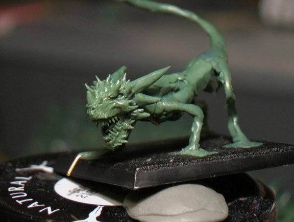

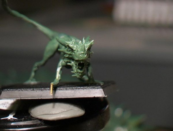

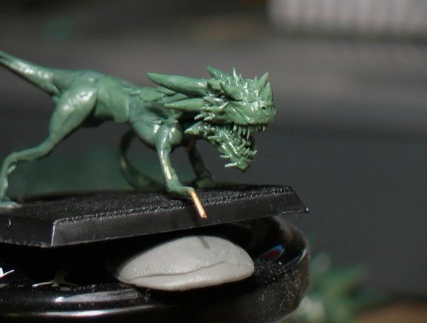

    As a teaser, I've been hard at work (combination of Razordon, horned one and my cold one unit), I will be uploading a much more detailed tut soon (today), but here's a teaser for you on the head I've done.
    Will post better (clearer) photos towards the projects end.

    Wow, it's just a wip and already better than GW's ones! Great job!

    Thank you, not massively happy with it, personal preference wise, probably a 6.5 out of 10, but occasionally these things happen.

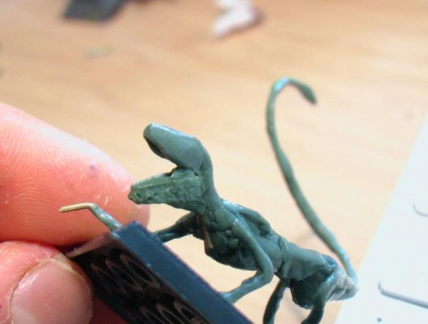

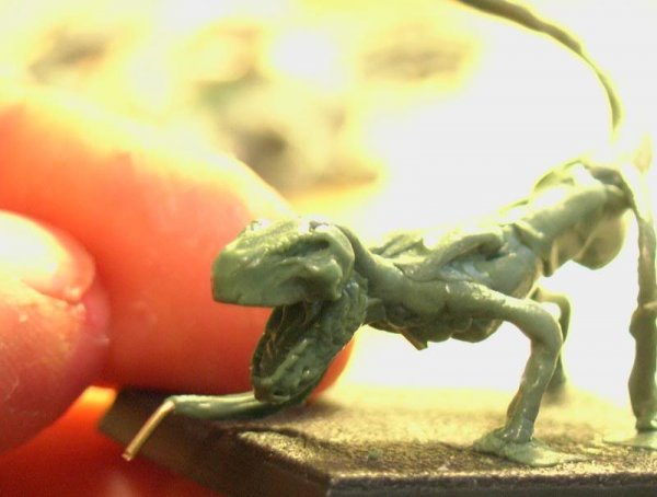

    Anyways moving onwards with the tut; this will cover the head but the following bits will not be as full on as this one, because areas like the head and face are always more complex and multi layered (and some parts here will be repeated/re-used in other parts).
    Continuing from where I left off:
    As before, I asked some very important questions, such as, what does a razordon do? I now need to go one step further with this by looking at real life equivalents, in this case the thorny devil.
    Seems like a very nice candidate from the huge amount of spines on it, so this will be a guide to refer to in making the Razordon. One thing that stands out nicely (and fits in with the fluff of a Razordon flicking spines at its foes) is the larger spikes, they have pockets with smaller ones growing out of them, something I'm going to try to combine with my Razordon.

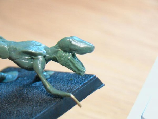

    You all saw the basic armature from before, well this is where you add more to it, though I should poiint out I got carried away and rushed things by going straight into a detail layer without building up the initial layer a little more first (a huge no-no).
    What I've done is have a little practice with the green stuff and a clay shaper with an edge, though this is a bit of a bit idea, green stuff is thick, but not good at all for very fine work and attempting to do so can often leave a scratchy detail layer if you're not careful.
    What you can see that I have done however is to try to give it a slightly weathered look around the bottom of the jaw, I've also poked some holes into the green stuff which I can then slide spikes into on a later stage. I also add in a detail layer to the top of the head and begin to create a basic structure shape (though less like a theropod dinosaur and more like a lizard) I haven't really opened the jaw either, but this is deliberate as you will see when I move on to the Salamander tutorial (I don't want them looking like distant cousins, both live in very different areas and hunt by very different means so their appearance and evolution needs to reflect this).
    I now pull out the cheeks on the upper head by adding in large blobs of green stuff on either side and pulling them both towards the snout as well as down towards the lower jaw, this is to add thickness to the upper skull and leave some nice areas for details. As with the lower jaw, I slide in some holes and push all the way around on the inside to make it look more sheath like for the spikes. I also add on a top layer and sink in the eye sockets.

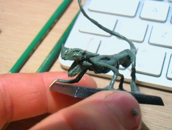

    I now move on to the larger head crest spikes, as before I stick them on and then poke holes into the putty. I also add in a tooth brace to the upper and lower jaws so I can slide and sit the teeth infront of them a later stage.
    Now my favourite part...spikes, plenty of spikes, scales and horns, very time consuming but all down to how you want the piece to look. As always the best results are the most annoying (which means doing them individually). You can also see the tooth brace I mentioned, sitting in the bottom jaw.
    Afte the upper jaw is finished it's worth taking a drying break to settle your nerves and let the upper teeth harden, before you move on to the lower ones. I have also designed the teeth to be thinner, but not particularly long (not like a big dino which has long serrated teeth for ripping its prey apart), this is because of it's back ground fluff, it's not designed to rip things apart as part of its hunting tactics, it uses spikes it flings from its tail instead.
    By that same vein I have not chosen to give it a wide gulping mouth either, no point as it again ties in to how it works, salamanders on the other hand need a very large radius for opening its mouth in order to spit fire, no-one wants to burn the inside of their mouths. I've also used this stage to make the eye ball and slide it just behind the lower eye lid, I then smooth it out.

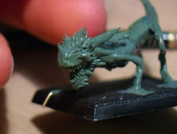

    I now finish with the remainder of the teeth and add in the upper eye lid and some more scales, things aren't finished yet, the head looks a little flat just above the eyes but this is something I can correct/add to as I go along.
    NOTE on tools:
    I find with scales and weather effects, you're much better off using wooden tools, metal ones can be a bit too scratchy (green stuff is also much more likely to stick to them) and clay shapers tend to be a bit too smooth.

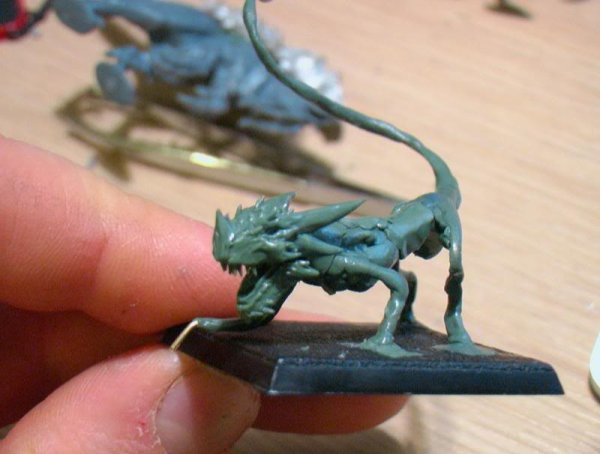

    EDIT:
    Made some small changes to the head and the spikes, including around the snout and nostrils.
