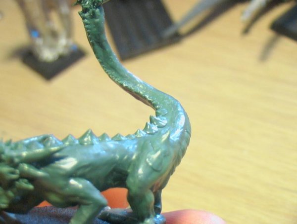

    With that said, I start off from finishing the work on the spikes on the tail, though luckily at this point most of it is done and all I have to do is fill in the blanks (or scales in this case). My reason for the under side scales on the club end not being like the ones on top is the same as for a Tarantula, flickable spikes on top makes sense, less likely to get caught in anything, easier to flick off and you don't need to over/off balance yourself quite as much in doing so (it's also a perfect excuse for me to not have to spend AGES sculpting these scales all over the bottom too).
    Next bit is to lay down some of the muscle bands to the tail and create some thickness to it. I know very little on dinosaur anatomy and do my best to look at research books and sculpts to at least try to get a feeling, both for the muscles and the movements/stresses involved and although a creature like this does not exist in the fossil record, it's still possible to get an idea of what is needed (I look at large sauropods for some help on this, as some have large whip like tails). This same pattern of muscle bands can be seen in other dinosaurs too, so I start by layering down bands (top first, then bottom, then the middles section on either side and rub vigourously with metal and wooden tools to hide the joins*)
    *Something new I thought I'd try here to help in deciding which putties to use.
    Green stuff: Big problem with it here is it's bubble gum like consistency, it means for joining two separate areas, even when both are freshly mixed, that you have to really press, work and rework the joins with metal and wooden tools to get the two different areas to blend together and hide the join, something that is nowhere near as long or irritating if you're using softer baking clays like fimo or sculpeys.
    I also use lighter tools like clay shapers to add in shape on the underside of the tail and a bit of texture (though if you're planning on casting your work, don't go too light with detail otherwise it might not show, especially if you're casting in metal).

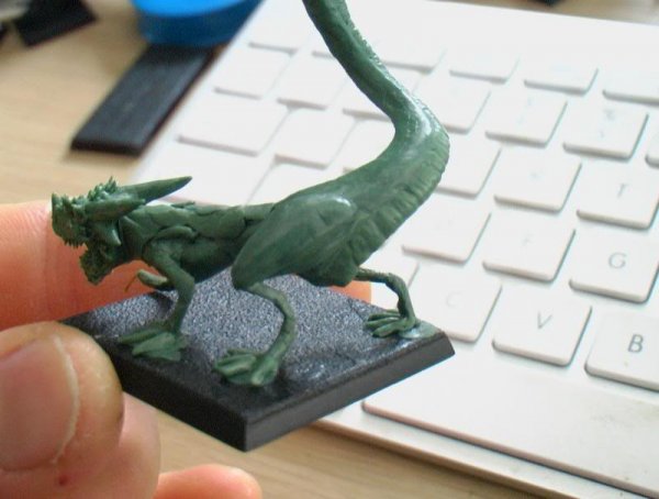

    Anyways, despite getting caught up with ideas and not finishing anything at all, I've hardened myself and gone back to finishing what I started. This is proving difficult to say the least, especially when you realise you make mistakes. Mistakes that require you to back track can be exceptionally crippling for moral and your confidence as you're having to cut back loads of hard work and go at it again, luckily there are ways to soften this blow.
    It is for these reasons I have included this as a little part of the update on this project. It also helps to show that everyone makes mistakes (yes, even me) and no sculpt will ever go 100% right from the word go (I can, if it helps, show you some more examples on the banshee/Wych I'm working on as I had to re-work a lot of that).
    So what was the mistake?
    The mistakes were two fold, the first being the previous stage (building up muscles)
    The second was the feet.
    First mistake.
    Fleshing out as I did previously only works if you're not using thick air drying clays or epoxys, as you can add detail over the top of it, better yet, a thin detail layer of clay is also possible for adding to a piece, but again, not so with green stuff.
    Second mistake.
    The ideas behind the feet might have been good, but the execution was not, too rushed, too lacking in detail and if I'm being honest, they were lacking in more research before construction. Doing things like this is exactly what I mean when I say, these can come back to bite you, if you don't research or reference your subject thoroughly enough.

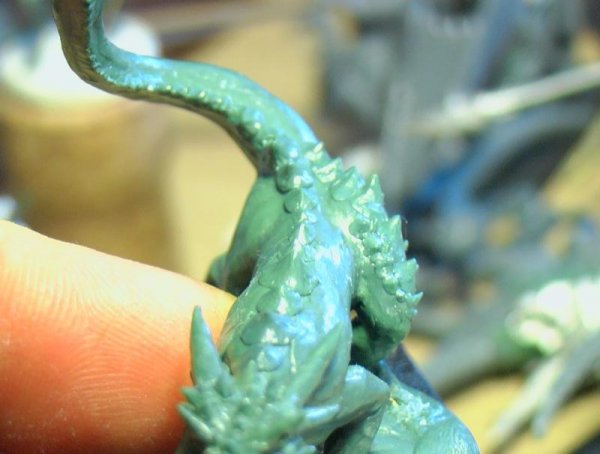

    So best place to start is with the back thighs, work on the big ones and get smaller as you work outwards. The principle here is to have a play, experiment, even if you have a nice approach with scales, they really do come in all different shapes and sizes and with different models, different scales are essential to avoid blandness.
    I also break with tradition and practice by sticking thin, longer spikes into gaps between the larger ones, this will also help to tie in with the thin spikes on the end of the tail, especially if I increase the number of them, the closer I get to the tail end. This also stops the mini from looking like a cut and shut.

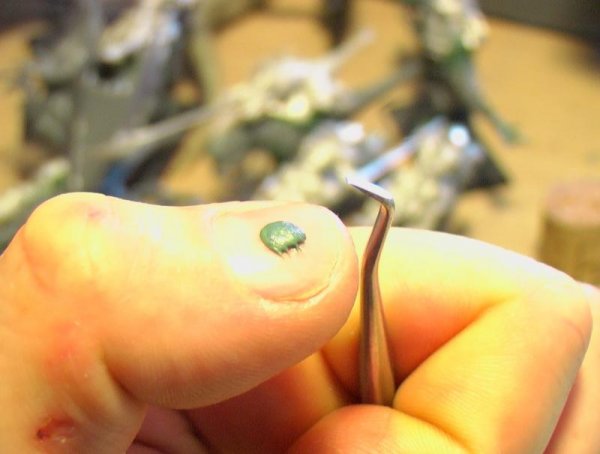

    While on the subject of scales, I figured I'd throw in a sneaky peak at how I do scales and teeth; rolling out tiny blobs of GS is a royal pain, especially as sebum from sweat and your hands, removes the sticky quality of green stuff, which is not what you want when doing teeth and scales/spikes.

    Scales placement and patterns.
    I tend to lay down individual rows of scales starting with the centre most ones (larger ones, so I get to have more of an experiment with shapes an detail), I also leave deliberate gaps between these rows, this allows for filling the spaces afterwards and giving a little more structure and purpose to the patterning.
    As for the legs, I'm only adding the bare minimum here at the moment, until the lower legs have been done, there's no point sculpting anything below there, it also gives me a little more time to think and plan ahead as I need to be mindful about areas with a lot of skin movement (areas like elbows and knees as scales over the top could severely hamper movement.
    I continue now by filling some of the holes, though scale work is still at a bare stage, where I can see what works, what doesn't and give myself more of an idea of thinking ahead for the next set of stages.
