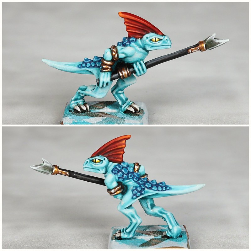

Thanks! Very glad you like my work!
The skin was:
- Sotek Green
- Wash Nuln Oil
- Sotek Green Again
- Edge highlight with Temple Guard Blue
- Edge again with Baharroth Blue
The Scales:
- Stegadon Scale Green
- Wash Nuln (I do this all over the model at the same time)
- Stegadon Scale again to paint every scale completely
- Edge highlight with Thunderhawk Blue
- Dot in each corner of each scale with Baharroth Blue
- Glaze all over the scales with Guilliman Blue
Thanks so much! Also oof that's a lot of paints I don't own. When you say "paint each scale completely" do you mean you painted each scale individually avoiding the recesses?
Yes exactly, cover the top of each scale completely leaving the nuln oil into the recesses, don't leave the nuln oil in the middle of each scale.
Also yeah, they are a lot of paints bit I do own all.of the Citadel range so I tend to be a bit spoiled with that. I hate mixing
@Itepixcauh Last question (sorry!) - what varnish do you use and how do you apply it?
That depends. For showcase models I use AK Interactive Ultra Matte varnish applied with a brush avoiding metallics. That is the flattest most amazing matt varnish ever made.
