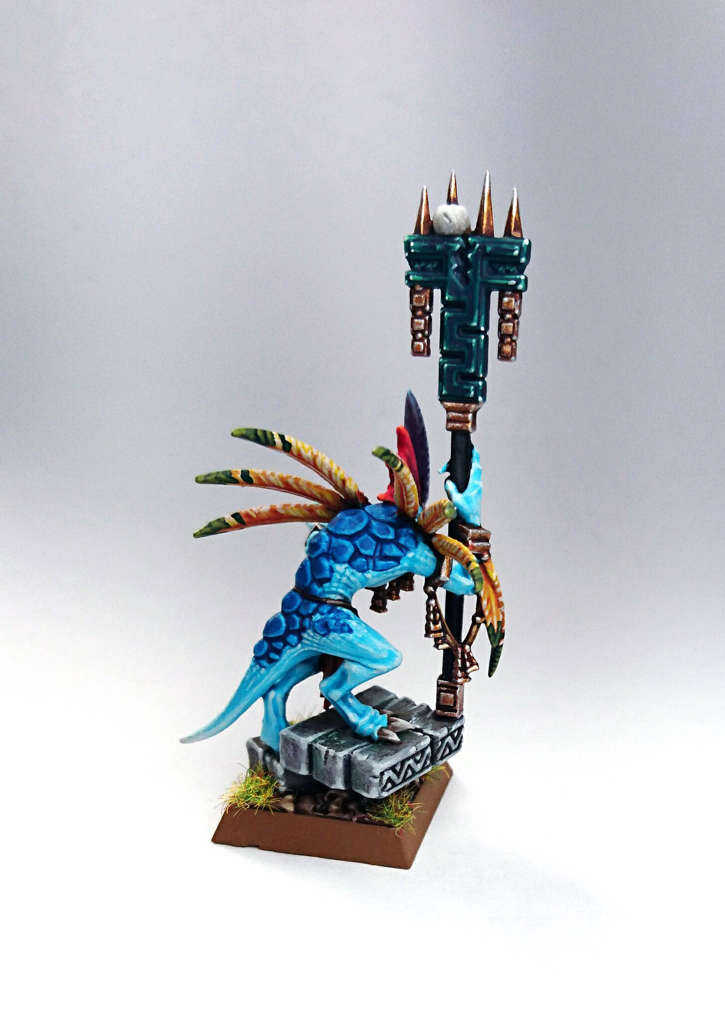

Thanks guys, very kind words! Next in line is my skink priest.

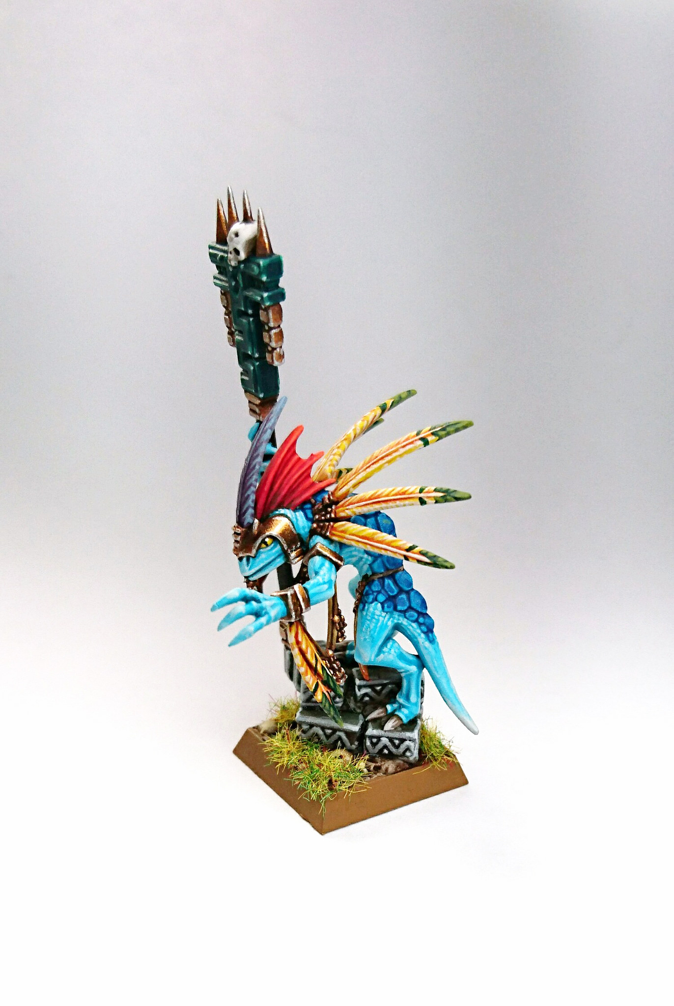

First I finally have my first hero done, he is acting as a Mage-Priest now, hope you like him!! Also sorry for the quality of the pictures he is a very hard mini to photograph.

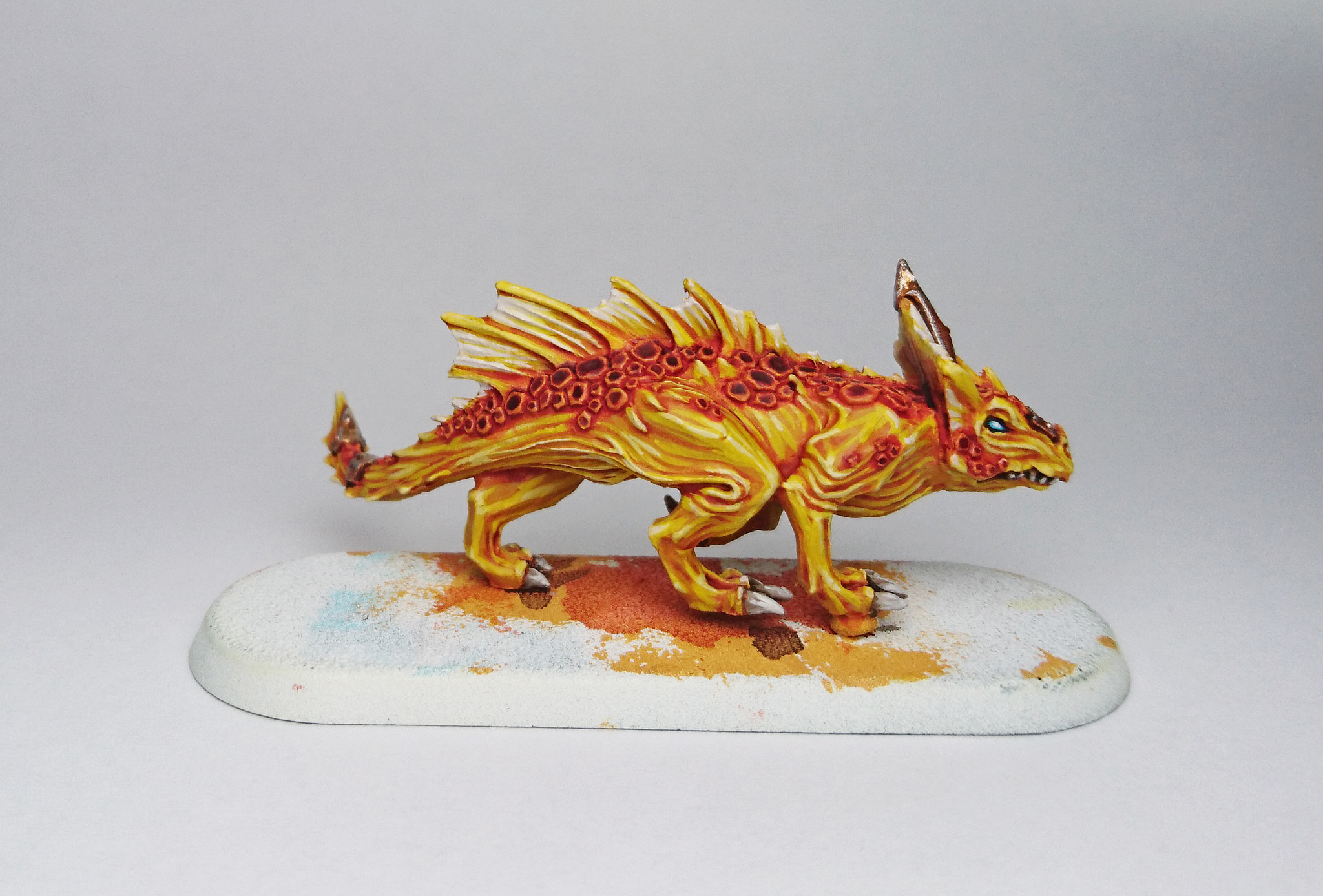

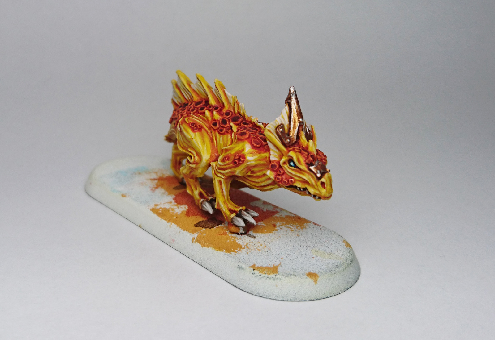

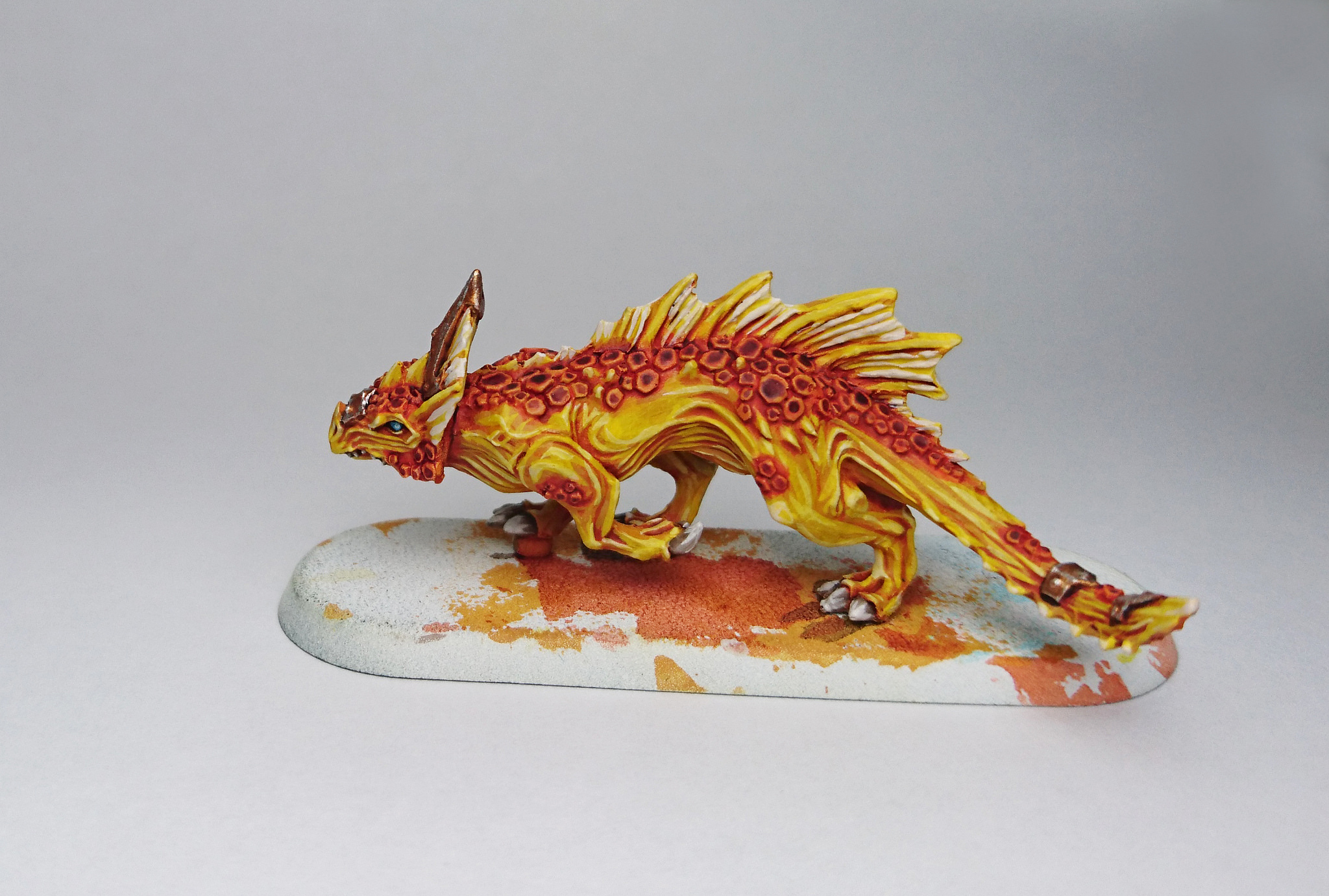

And on a WIP update I've started with my Salamanders, that will be my first Multibased mini and will be used as Fire Elementals. The first one is finished and awaiting for the rest to be finished to glue them on the bases.
I've gone for a very Fire like look.

That looks really cool!! I specially like the purple feather on top of the head, it's a nice touch!
Yes! The feathers are really nice! Mind if I take some inspiration from this?
Of course not! Colours used are as follows:
Yellow:
Basecoat: Averland Sunset
Shade: Fuegan Orange
1st Highlight: Averland Sunset
2nd Highlight: Flash Gitz Yellow
3rd Highlight: Palid Witch Flesh
Green:
Basecoat: Caliban Green
1st Highlight: Loren Forest
2nd Highlight: Elysian Green
Purple:
Basecoat: Daemonette Hide
Shade: Druchii Violet
1st Highlight: Daemonette Hide
2nd Highlight: Warpfiend Gey
3rd Highlight: Fenrisian Grey
Hope it helps!
