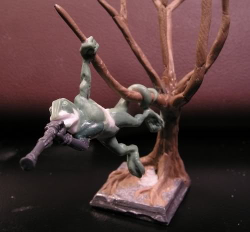

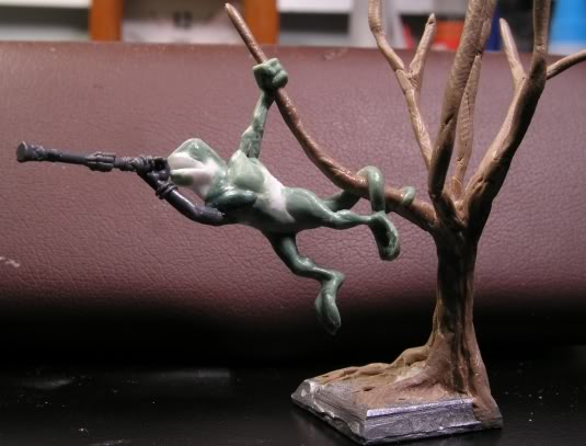

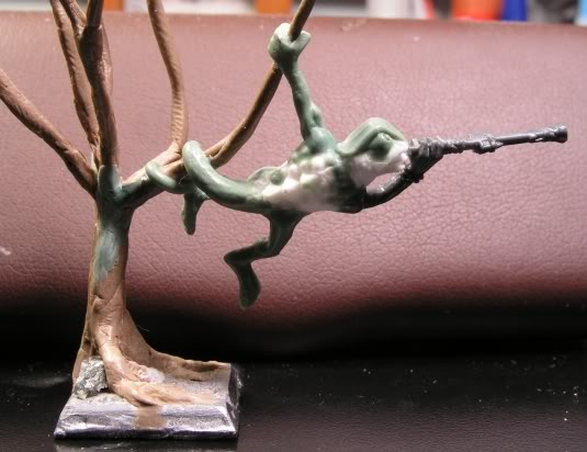

    Thanks guys! Been a busy week for me, so I am only getting around to posting an update now. Looking forward to reading any comments over the weekend. The little tree hugger now has his face and legs in rough form...pretty close to being done. Have a look:
    And a couple of other views of the mini:

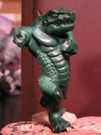

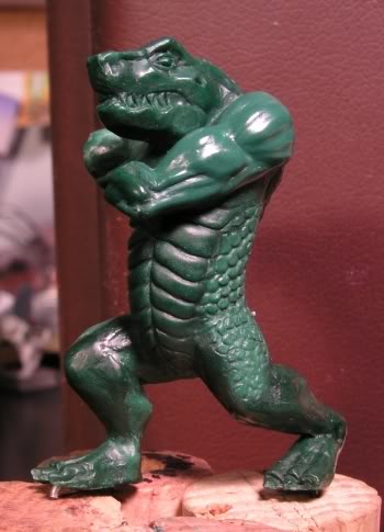

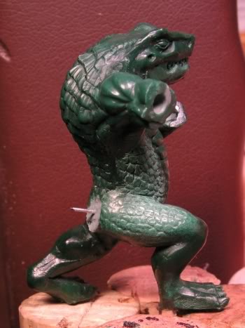

    Meanwhile, I thought I'd toss out a few pictures of one of my Kroxigors, which has been cut apart so that it can be placed into a mold for eventual casting. Here's where I'm at with the first one, and I'm pretty happy with it so far:
    I am going to leave the areas below the knee, the abdomens, faces and arms essentially free of scales. The sides of the torso will have some minor texture, building up to the pronounced texture you can see down the back. There will be no mistaking the "croc" part of these Croc-ogres. Let me know what you think!

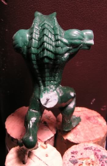

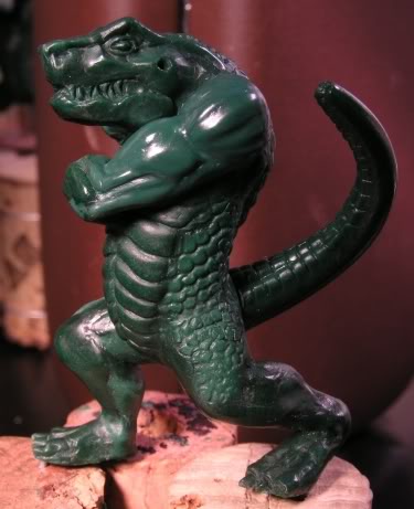

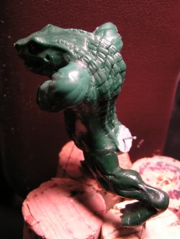

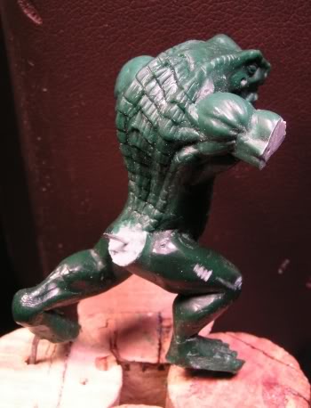

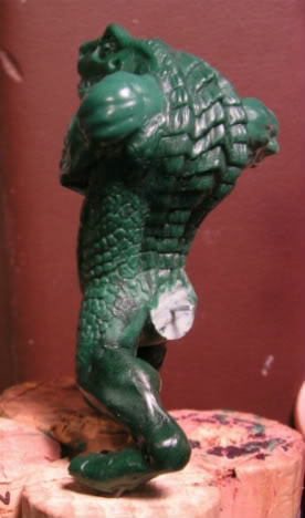

    Some more WIP photos showing the smaller scales on the sides and the texture added to the belly:
    from the rear:
    and a last photo showing the tail as it will look when attached:
    Sorry this last photo came out a little dark, but it should answer your question Krox_v.2,. I am not planning any spikes (or other weaponry) on the ends of the tails. If you want to add that stuff it would be an easy conversion.

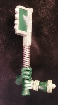

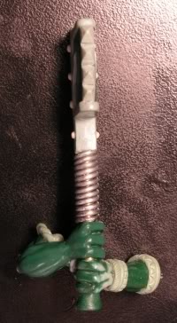

    Started work on the other one last night, but no photos yet. I absolutely intend for these to be commercially available within a month, most likely with Troll Forged. I need to take a set of definitive photos and shop these around and see who will offer me (and all of you) the best deal. Meanwhile, here are the arms and weapon, which should cast as a single part:
    I also fixed his feet and some other small imperfections. I need to put it back together now with blue tack and take new photos from all angles. Comments welcome :)
