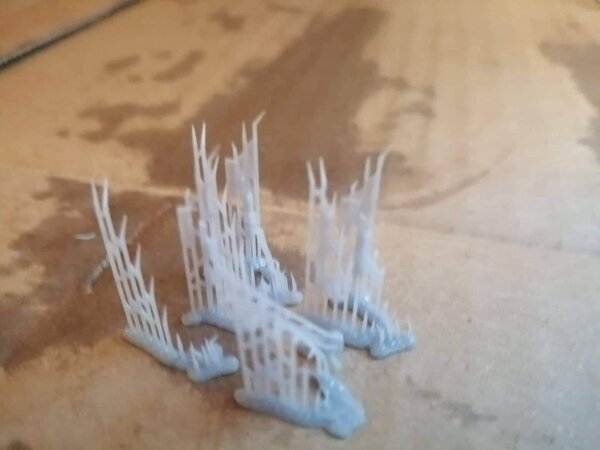

    I have received info on my clubs for warriors. My supports were too weak and it basically detached immediately. received_349626850527208.jpeg

    Would you like assistance?

    i mean with printing, and how to fix your supports.

    Thanks, but that is not really necessary. Since I personaly do not own that printer, I'll leave future model supporting to owner. He knows that machine better. I just wanted to help him out by relieving of doing them. I did more harm as he had to scrape fails and filter resin. But I appreciate the offer and would definitely accepted it if it was my printer.

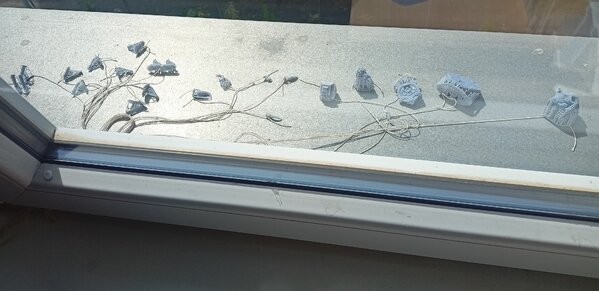

    Thanks a lot, but I sent him unsupported model, he did it himself and it printed properly. I am currently curing them behind my window :)
    I think you are right and support connection points were too small.

    Dear fucking gods, he sent you uncured resin in the mail or straight up gave you uncured prints?
    That's a carcinogenic and toxic material pre curing. That's a safety hazard and you should be wearing nitrile gloves when handling uncured resin and wearing at least a paper mask, if not a carbon filter mask.
    More to the point, they should have been dumped In an alcohol bath straight after printing, washed, swapped to warm water, debrided from support structure, and then we get to curing by some form of UV light.

    Supports are most easily removed after printing, before curing. because they are semi-cured during the printing process, they are bendable and pliable at that point.
    once you cure them, they become fully rigid. if you do the cleaning process as i outlined above, and submerse them in warm water, you can flex the raft with your fingers and they should pop right off.
    if you cure them beforhand, removing them will cause worse contact-craters then pre-curing.

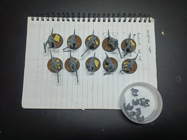

    Guys! It worked! I converted first 12 warriors from spearmen to clubmen (where is that disco music coming from?)! I also managed it using my own design of clubs and pining parts onto miniatures for the first time! IMG_20220718_212416.jpg
    Also, Slaan is mostly glued together. I have to use some putty tomorrow.

    excellent work on repurposing those saurus.
