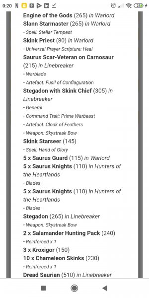

  6. Kakalou1
    Kakalou1 Member
    65
    36
    Thank you guys for the inspiration
    For what it is worth I préfèr also the Steg chief and Priest
    What if you had to run a 3000pts with this base list ? (Big battle next week aha)
    I add some salamanders and cameleon for mw, few kroxigors mostly for the fun and 1 steg as battleline
    (I avoid any bastilladon which are a little bit too good against démon)
