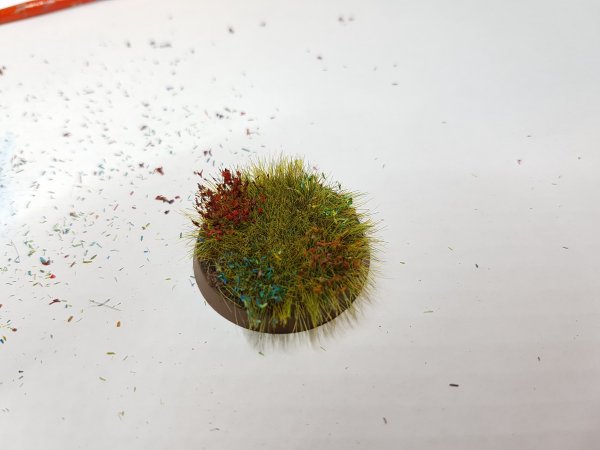

    Ok here it is. Keep in mind this is a very rough first test. But I think it looks promising.
    In the upper right corner is the unpainted material, then (clockwise) orange, blue, and red.
    I applied quite a lot here for the color test, I guess normally you would probably apply a bit less.
    The coolest thing is that you can make as much as you like in the colors you like.
  2. Ritual
    Ritual Well-Known Member
    2,407
    7,407
    Hold on, I don't quite get what you did... You painted stuff to get the orange, blue, red? The grass in the top right, can you do a larger base of it so I can see what it is?
  3. Aginor
    20,175
    Ok maybe I wrote some stuff badly understandable, let me quickly re-iterate over it:
    The grass is regular Noch #07104 electrostatic grass, this one: https://www.noch.com/en/wild-grass-bright-green-6-mm-07104.html
    The stuff I applied as flower petals is this: https://www.noch.com/en/scatter-material-flower-meadow-08400.html
    I painted the #08400 scatter material by basically mixing it with a drop of my Army Painter acryllic paint.
    Then I put some PVA on the finished grass and touched the PVA drops with the painted #08400 scatter material.
    So the top right corner is just the #07104 with the unpainted #08400 on top, in the middle of the base (or on all my other grass bases in the blog) you can see the grass without the #08400.
    The other corners are the differently painted #08400.

    Ah, that makes a lot more sense. Somehow I thought you had pre-made flock with flowers... Was wondering how you got it to stand up.
    Pretty cool, might have to investigate this...

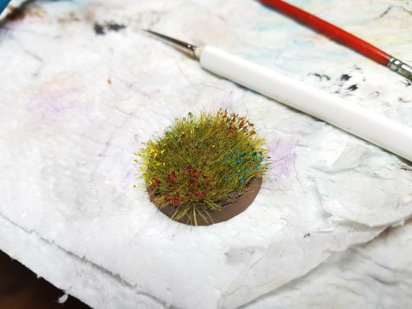

    Ok I tried the yellow again and it worked. The trick was to use some white first, wait two minutes and then put the particles into the yellow. With a thicker yellow paint it will work without that step in between but I was too lazy to get one. :D
