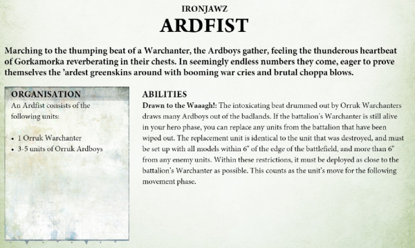

    As I got the new Orruk Warclans Battletome I was going over the battalion that I liked the most in the old Battletome: Ardfist. And I noticed some changes.
    I'd like to know if I am reading it all right.
    The old Ironjawz Battletome stated the following:
    As it clearly says: "During the Hero phase" and "The replacement unit is identical to the unit that was destroyed."
    Also bear in mind that the minimum unit size of Orruk Ardboyz is 10 models.
    The new Battletome says:
    (1) "You can use this command ability..." so this is still in the hero phase, am I right?
    (2) If you succeed the roll you can set up an unit of 10 models. regardless the size of the old unit(?)
    Also the minimum unit size is changed to 5 models(although to count as Battleline it still needs 10 models)
    (3) SO... If I for instance would use 3-5 units of 5 Ardboyz alongside a Warchanter and 3 units of Gore-gruntas (Battleline in an Ironjawz army) I would be oke Battleline wise.
    Now when a unit of 5 Ardboyz is destroyed I might probably replace it by a unit of 10 Ardboyz for free?
    (4) As it now also states "is added to this battalion"... When that unit is destroyed I can try to replace it again?
    (5) Finally: If one unit is destroyed, say in turn, and in turn 2 I try to replace it but fail. Can I still try to replace it in the upcoming turns? Or would it be 1 try for every unit?

    You use the command ability when the unit is destroyed. So during whichever phase the unit is destroyed in. However, there is no cap on the number of times the command ability can be used in the current rules. So if one unit dies and you have 8 cp you can spend all 8 on attempts to bring in Ardboyz. Imagine this with Aetherquartz Brooch!
    You are correct. Any newly added Ardboyz are part of the battalion and their destruction can be used to activate the command ability provide all other criteria is met.

    No, I don't think so. Any time, right after a unit gets destroyed.
    Yes, regardless. Replacements are always 10 Ardboyz.
    Btw: the way I read it a unit of five is still Battleline if you play Ironjawz allegiance. Only in a Big Waagh army you need 10 boys units to be Battleline.
    Yes.
    Yes.
    You can try again.
    In fact I'd argue that you can try again in one round, if you have enough command points to do so.

  6. Killer Angel
    18,730
    39,212
    No, you can't.
    You can use the ability "when the unit is destroyed", so you must use it in that precise moment.
    If you have more than 1 cp you can try again for that unit, but that must be done immediately, you cannot wait for the next turn.

  7. Aginor
    20,175
    Oh, yeah you are right, I misread that part of the question. He can try again, but he has to do so immediately, not in a subsequent turn.

    3,389
    looks like you would be limited to having 5 units total in the battalion, so using multiple CP to bring back more than one unit of 10 would still be limited to a max of 5 units because of the battalion cap. as said above under the new rules there is no inherent limitation to using this command ability multiple times so long as its done when the ability triggers, and you don't move from that point forward (ie make a move, attack with another unit, etc)
