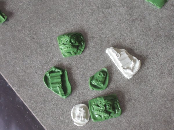

    Love the examples, not boring at all! The skulls seem to come out the best, looks like smaller lines might be a little tougher to achieve? But painting should fix this with no issue. Thanks again for sharing this!

    Well skulls do work particularly well but I think it's also due to my amateurism.
    I didn't bother using strictly plain surfaces as bases for my moulds, so some of the pieces moved a little when I was pressing them and a few details def dont come out as sharp as they should. I was thinking of this as a first attempt which would necessarily be a miss so i thought i'd keep the best bases for actual moulds. Now i realize actually i couldve made the first shot quite well, and the trials i did look good i dont wanna waste too much GS by seeking perfection (i sure will for my next moulds tho ^^). So if you're gonna try it, you might as well use a flat base, chances are you'll just need one attempt…
    Also, I used a better suited quantity of GS to mould them while i came up short on some other pieces because I underestimated the amount of GS I needed (on some pieces, the highest part reached the base as the GS layer wasnt thick enough).
    And one last thing: it may have sth to do with how well you manage to press the GS onto the bit once you've pushed the latter into the first.You need to keep the part still so that there is no distorsion on the mould and still manage to make the GS really stick to all its parts, i'd say thats the tricky thing. Maybe i messed it up a little on certain parts :/

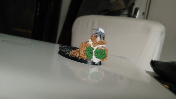

    Wip wip wip wip :D
    This is starting to take shape but milliput sculpting sure takes practice..
    Any thoughts? ^^'

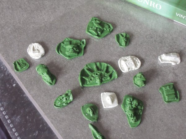

    Thanks for all the example casting pictures showing the miliput/plaster/GS differences! Your casting efforts are growing quite prolific!

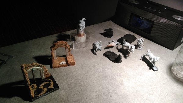

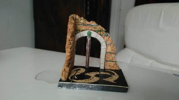

    So more wip!! Priming and casting and more marine basing. The window one is done now I guess :) I'm be using the marine on the pic to determine whether I'll go for black or white primer on my salamanders. Any thoughts on this matter?
    I'll upload pics of the casted cold-blood parts very shortly.

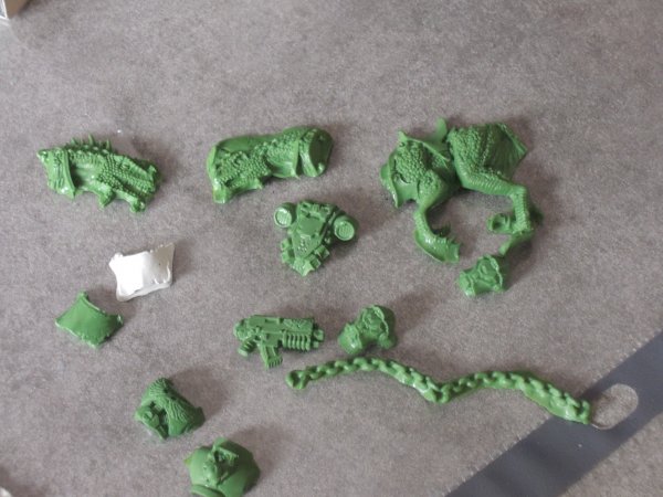

    Sooooo new step in my GS/Milliput/Oyumaru experiments. Here are pics of some of the pieces I've been moulding using each one of those 3 materials and casting, for certain parts, with either GS or milli. So let's show you some results, ye goode lizzie freondes!!!
    - Pieces from GS moulds:
    - Pieces from Milliput (white, extrafine) moulds:
    - Pieces from Oyumaru moulds.
    So when it comes to casting, i havent really changed my minds since the last comparison I offered between milliput and GS. As for making moulds, I've tried to narrow all of the relevant characteristics of our 3 materials down to the 4 main important qualities, i.e. how precise they are, how cost effective, how easy/quick to use, what possibilities do they offer.
    - Precision: GS and Oyumaru are both very precise (the bolter i casted even has a mould line from the original on it hehe).
    - Cost effectiveness: Oyumaru. It's reusable though not exactly cheap, and once youve made the mould you don't need to use any extra material when casting a piece, since you just have to push it out of the mould (it remains pretty flexible): no need to leave a thick layer of putty which you can pull, you just put in exactly the amount you need for the GF to fill the mould. You can choose to make a "hollow" part with a thin layer of putty all over, or thicker so that it retains its shape better and feels more solid. Anyway you dont use any more putty than strictly necessary to create the part.
    - User-friendliness: Oyumaru again. It's so simple to use, just put it in hot water, let it warm up for a couple minutes, mould, let it cool down for maybe an hour, remove the piece (super easy), then fill with putty, let it cure for a day, remove by pushing (it's stupid easy to push them off, really). No need for oil, the mould is quickly made.
    - Potential: I'd say oyumaru. I just made some 2-part moulds for 'all-around' parts (like Saurus TG bodies, basically anything that needs to be cast in 360 degrees) so I'll be seeing how it turns out and giving you guys an update very shortly, but i got a hunch it's gonna be ok… fingers crossed :D Plus, being reusable and rearrangeable (you can stick two pieces of oyumaru together to mould a bigger part), it really allows you to do whatever you want. I may be casting an entire land speeder and a troglodon (Carnosaur casts + spare troglodon parts) with it soon…
    So overall, Oyumaru clearly has the upper hand for me, it's the best compromise. I'll prob be giving it my preference for my future moulds now I have it.
    Now once again this is only my opinion, you guys may have a different experience. If you do please say so, it'll be useful :)
