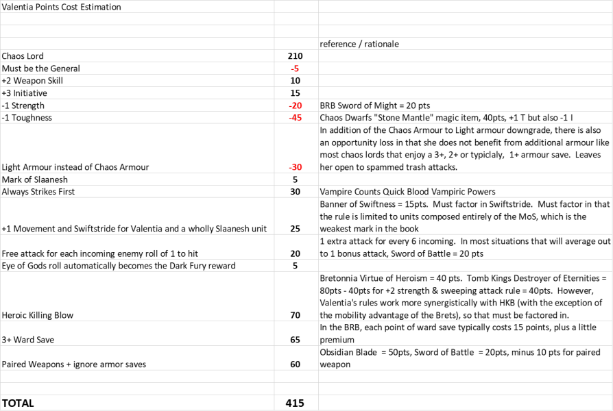

She's clearly a difficult character to price with her rather swingy ability set. Without tipping my hand too much, I can say that my calculations of her points cost is vastly different from either of you. But that's why I've set up this thread. To open myself up to different points of views, potentially identify things I may have missed and to shield against any personal bias I might bring to the table. That's also the reason I've embraced the new world and brought several AI chatbots into the mix.
I've finished the draft of my next two characters. Now I need to write them up nicely.
Well, I suppose I have to give up on the idea that more votes will come in. No point in holding back my calculations any longer. Here is what I came up with as a loose guide, give or take some points:
Other considerations
Positive Synergies:
⚫ASF + WS10 + I10 + A6 + HKB
Valentia's entire offense is built around this synergy. She is a one-on-one duelist who relies on landing her heroic killing blow. It is an extremely potent combo and without it, Valentia is pretty weak. However, against large multi-wound models, she is an absolute killer. She always has the chance of taking them out in one single shot and often times can threaten to do so before they have struck.
Negative synergies:
⚫ mediocre toughness + light armour
Despite her massive 3+ ward save, she is vulnerable to high volume low-tier attacks. This is why the infantry battles above were so decisively poor. A typical Chaos Lord or Saurus Oldblood is rocking a 1+ armour save (sometimes re-rollable) and a 4+ ward; each of which is stacked onto T5. This makes them near immune to low strength mass attacks. Valentia's defense is weak... too weak.
⚫specialist fighter + limited mobility
Valentia's impact is extremely matchup dependent. If she can hit big targets, she is a terror, if not, she can be brought low by simple infantry. Sure her HKB potential is far greater than that of a Bretonnian Lord, but he flies, while she is stuck with M5 (+ Swiftstride). He is able to hunt down key targets relatively easily, while she cannot. He can avoid targets that counter him, while she has much more difficulty doing that.
So that is my dilemma. Unlike with my previous characters, whose points total drew almost universal consensus, I find myself facing down a near 300 point spread. That makes things tricky! :eek:
