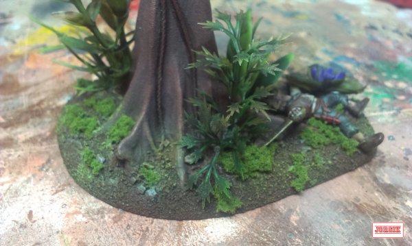

    So now as promised the finishing of the trees and some other stuff...

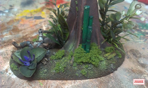

    Simple stuff here. First off I hot glued some plastic plants to the base and when they were dry I applied two light washes of agrax earthshade to remove that shine that plastic plants come with, and also darken them. I also glued some bamboo I made (wooden rods painted up as explained in the how to make scenery for wargaming book). Once all that was dry I glued down some bushes of clump foliage, then sealed them and afterwards stippled some nurgling green to break up the color monotony of the earth and also soften the sudden color change from the bushes to the ground. And that´s pretty much it :).

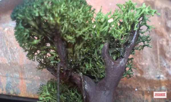

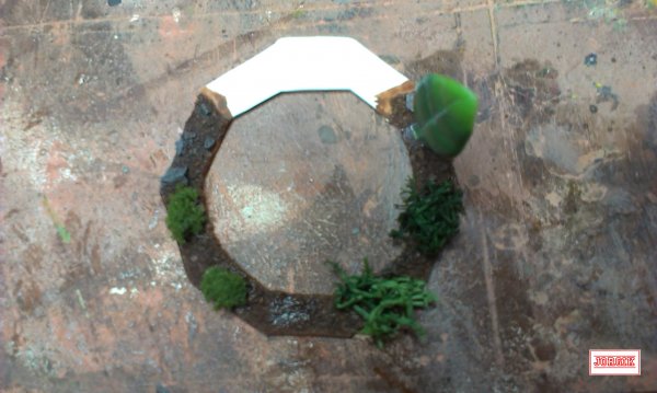

    Also I started to work on the test for the hair spray I bought to put on the trees´ lichen. I heard it helps it last longer, but wanted to try it out first just in case. I just stuck some sand on a piece of plasticard I had laying around, then painted it and stuck stuff onto it. (the picture shows the test piece before I added any hairspray)
    What I wanted to test was how the hair spray looked on (from left to right) bare clump foliage, sealed clump foliage, a blob of wood PVA (the shiny stuff in between the clump foliage and the lichen), bare lichen, sealed lichen, and a plastic plant, painted on one side and unpainted on the other. So far the hairspray seems to have caused the earth, the PVA, and the plastic plant (on both sides) to end up glossy, but the clump foliage and lichen (both bare and sealed) look perfectly fine. I´m going to wait for about 2-3 more days and then I´ll decide what will I do, which will provably be to apply the hairspray only on the lichen on the tree tops.

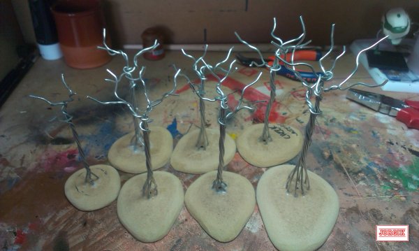

    I also started working on the next batch of trees :D:

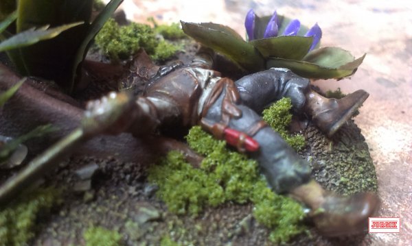

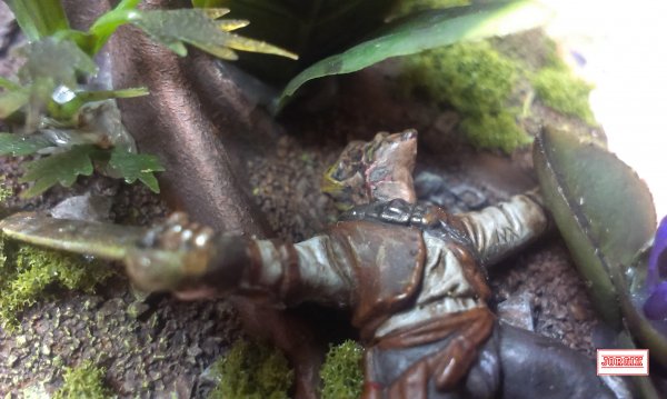

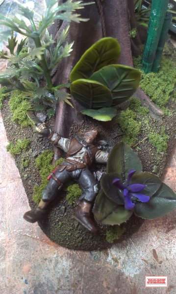

    Got some closeups on the unfortunate fellow bellow the tree mate?
    Jorgik likes this.
  8. Jorgik
    Jorgik Well-Known Member
    1,464
    2,329
    Here you go @Zenard ;):
    As you can see I placed some bushes under his left leg to avoid having it levitating over the ground :D.

    I will start with the experiment. After the good results I had with my little test piece, I applied the hairspray only to my small tree to do a second test. I only applied it to the lichen, because as I said it made anything that had been painted glossy. I got good results with the tree test but I see absolutely no difference on the lichen itself. If has the exact same touch than what it was before I applied the spray. The only thing that it affected were the top parts of the branches that it hit.
    So with this result I decided to not use hairspray. Maybe it´s just the spray I got (there were about 10 from which to shoos a the shop, so I had no idea of which one should I have taken), but it doesn´t work. :confused:

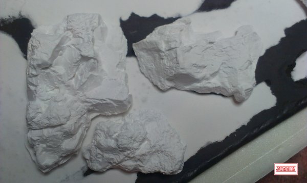

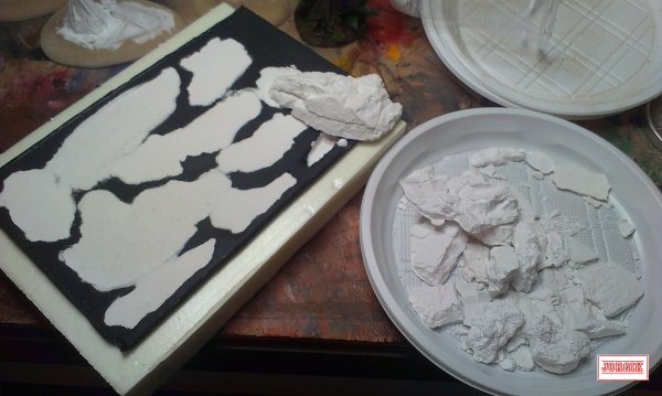

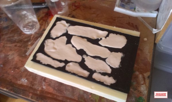

    I also continued working on the next batch of trees. I added the smaller branches onto them but did not feel like applying the clay, and I thought it would be cool to have some variation within the trees, apart from dead empire men laying on the base. SO what I decided to do was to simulate that some trees were growing on rocks, so I started casting rocks using the woodland scenics rock mould and their lightweight hydrocal.
    What I found out is first that I don´t know why I thought the plaster would dry in 45 minutes, and I was totally wrong :(. I think it takes them 36 hours, but I leave them 48 in case. So obviously what I did was pull them out before they were set, so they broke in half and provably lost some detail. Even tough, they are usable and actually at the end turned out to look pretty nice, and a quite high level of detail (tough I think not as much as if I had let them dry properly). Some of them actually broke horizontally, which I can´t understand how did it happened unless it was a water layer. Anyways, I corrected myself and casted the next ones. I don´t know how they turned out yet but I´ll post some pictures when I get them out of the mould.
    You can see what I meant with the horizontal division on the rock laying on the mould. I am reusing the broken bits I can´t fit anywhere, just turn them back to powder by smashing them and them just remix them. I am quite pleased at the moment even tough I screwed up on the first, but well, mistakes happen. Here´s a close pic of them.
    They have some air bubbles but I think that´s because I didn´t wetter the mould before pouring the mix. I´ll see if the new ones have air bubbles as well.
