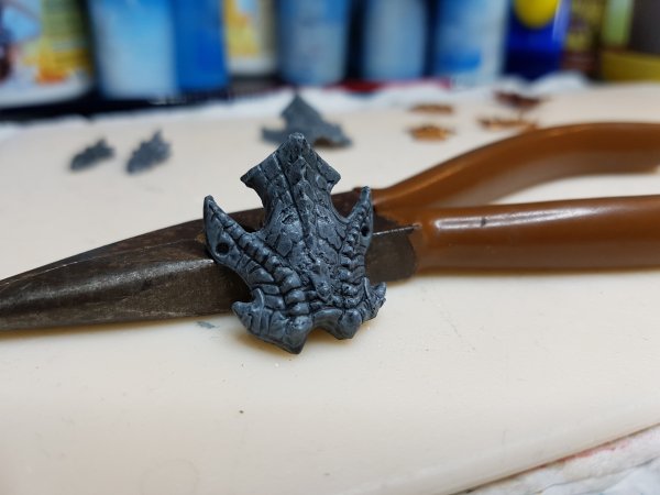

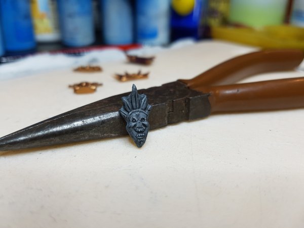

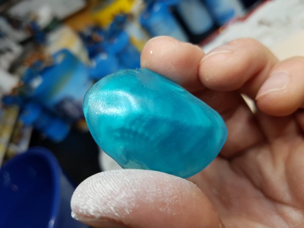

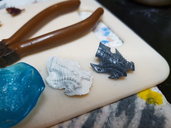

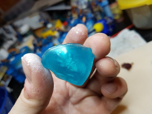

I don't have epoxy putty in my house right now so I just used some air drying polymer clay. Curious how it will look tomorrow when it is cured.
I also haven't tested two part molds yet. Maybe tomorrow.
But I did try and make a mold of a painted spare Saurus shield (not pictured) to try if it damages the paint job. It didn't as far as I could tell.
20171018_191818.jpg 20171018_191824.jpg 20171018_191835.jpg 20171018_191851.jpg
View attachment 36268 View attachment 36269 View attachment 36270 View attachment 36271

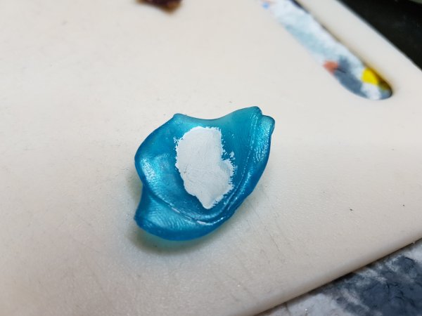

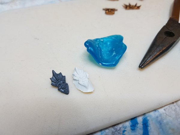

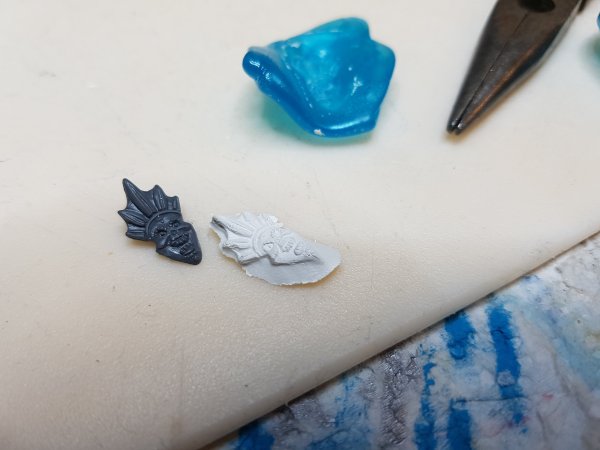

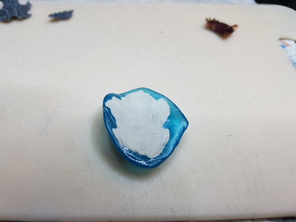

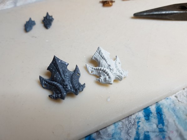

Here are my results!
I'd say there is no reason for GW to panic yet, but keep in mind this was only my first simple test using oyumaru and air drying clay.
It was super simple. And rather quick. No bad smell you can do it easily in your living room. No waste or anything either.
I will do more tests soon. I'd say it is perfect for terrain already but I think I can improve quality a bit by using other material and or practising a bit.
The minimum size of structures that you can reproduce is probably worse than what is possible with plastic as GW does it, but comparable to finecast resin models, at least if you use something like milliput.
But even with air drying clay you can probably still improve it. I saw a video lately that explained you can mix PVA and air drying clay to make it smoother to use it like epoxy putty while still being non toxic and way cheaper.
Will try that as well.
