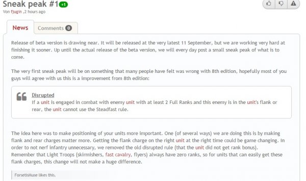

  12. Pinktaco
    2,696
    879
    Beta update will be out within 2 weeks. I think they're hoping it'll be close to finale, with only minor tweaking needed.
    After that I'm assuming they'll continue on with armies.
    skink chief likes this.
